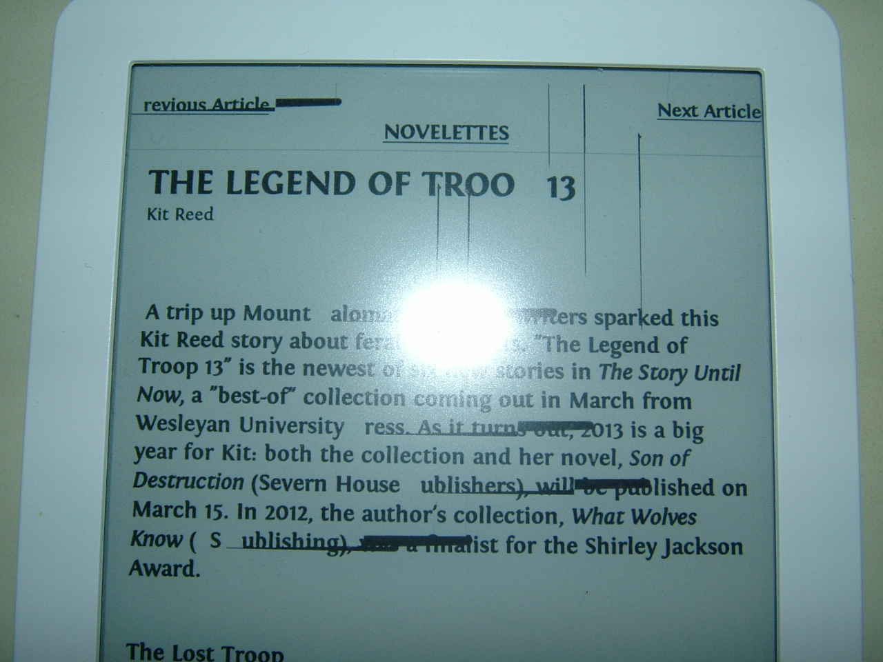

Old 12-11-2012, 10:40 AM   #56
ShellShock
ShellShock ought to be getting tired of karma fortunes by now.ShellShock ought to be getting tired of karma fortunes by now.ShellShock ought to be getting tired of karma fortunes by now.ShellShock ought to be getting tired of karma fortunes by now.ShellShock ought to be getting tired of karma fortunes by now.ShellShock ought to be getting tired of karma fortunes by now.ShellShock ought to be getting tired of karma fortunes by now.ShellShock ought to be getting tired of karma fortunes by now.ShellShock ought to be getting tired of karma fortunes by now.ShellShock ought to be getting tired of karma fortunes by now.ShellShock ought to be getting tired of karma fortunes by now.
ShellShock's Avatar
Posts: 1,185
Karma: 2431850
Join Date: Sep 2008
Device: IPad Mini 2 Retina
I thought I had broken my Glo's screen - it was displaying some pages with a lot of black horizontal and vertical lines (see the pic below) It turns out that this was due to the Fontin font that I had adjusted; I had increased the weight of the font (Regular, Italic, Bold, and BoldItalic) but the Glo was not happy with the increased weight in the Bold and BoldItalic. Strangely, the problem has only manifested itself in one book so far.
Once I had returned the Bold and BoldItalic to the previous versions the screen looked fine. I did not need the increased weight in the Bold and BoldItalic anyway, just the Regular and Italic.
Please ignore the big white circle in the picture, that is just my camera flash.
Wow - thanks for sharing. I would have thought the same as you (broken screen).
I have the same problem with the Linux which beedaddy mentioned earlier in this thread. Not as bad as what your screenshot shows, but illegible Bold anyway. Trouble is, even when I leave Bold untouched, it still doesn't display right. Haven't figured it out, yet.
bartveld is offline   Reply With Quote
I had a big problem with the Linux Libertine that bartveld provided and it looked like ShellShock showed but much worse. When I replaced it with the Times New Roman font name that bartveld provided on Dec. 1, the problem went away.
Do you mean that you renamed the Linux font to Times New Roman?! Or are you now using the Times New Roman font?
