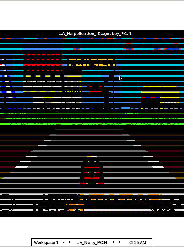

xgnuboy.
Got this built now.
Will look at sound next.
Thinking how to implement best on the 5.
running on 3. in 16 colours. dithered.
keys work and such.

For Kindle 3? What's the screenshot of, ie what's it running on as it's in colour?
Does the 'dithered' mean improved motion, like that of the Nook?
Sound would be awesome! When can I get my hands on compiled version please?
