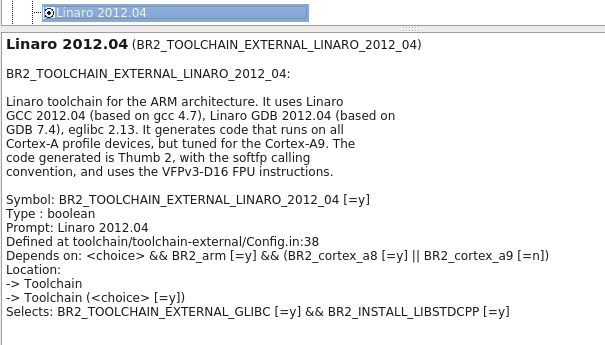

Binary Copy of Soft-float Linaro 2012.04 would be nice. *hint hint* : )
For a go-to OOTB k5 linaro flavoured solution at least
https://launchpad.net/linaro-toolcha..._linux.tar.bz2

Old 09-25-2012, 03:20 PM   #274
knc1
Going Viral
knc1's Avatar
Posts: 17,212
Karma: 18210809
Location: Central Texas
Device: No K1, PW2, KV, KOA
That one should work for things where you build up a new system in the /mnt/us file tree like you did with the K3.
For things which must be compatible with the K5's standard set of libraries - -
It should be possible to disable the hard float, the VFP3 (in favor of the VFP), disable the neon instructions ....
and whatever else makes the code in-compatible with the K5's standard set of libraries.
It should be easier this time (for the K5) because the tool-chain and the target device both use the eglibc system libraries.
