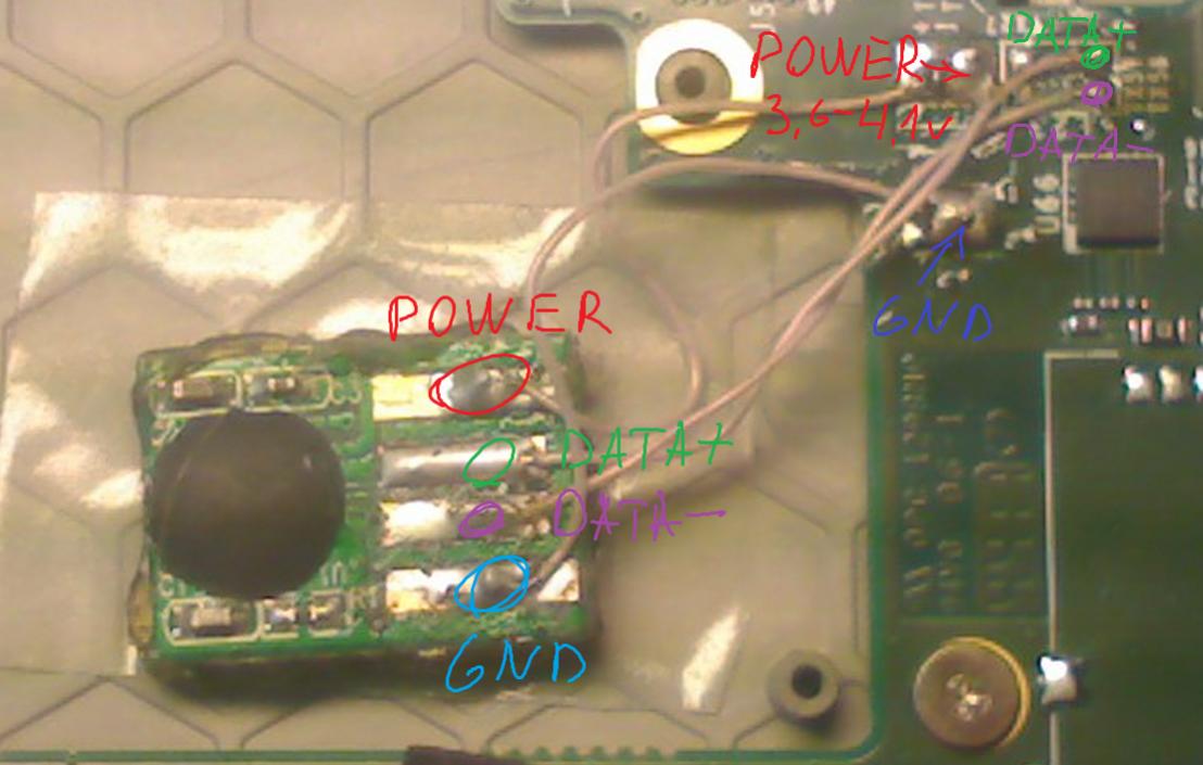

Amazon does not send to my country. It is a bad cable =) That's a good cable here.
Details in an attachment.

Sweet... what was the chip / adaptor that you used please
nice selection of cables there
I do not remember what it was for the adapter.
What is Chinese noname adapter (Example ebay, but it is best ebay. It is not necessary to disassemble.)and card Kingmax miniSD 8GB class 10. The card has a low speed.
I ordered a faster card for ebay . But do not know it will work faster. The card may not work...
It is best to find an adapter with a voltage stabilizer to 3.3V.
The stabilizer can unsolder and powered from the other bus to 3.3V.

Thanks very much for your help.

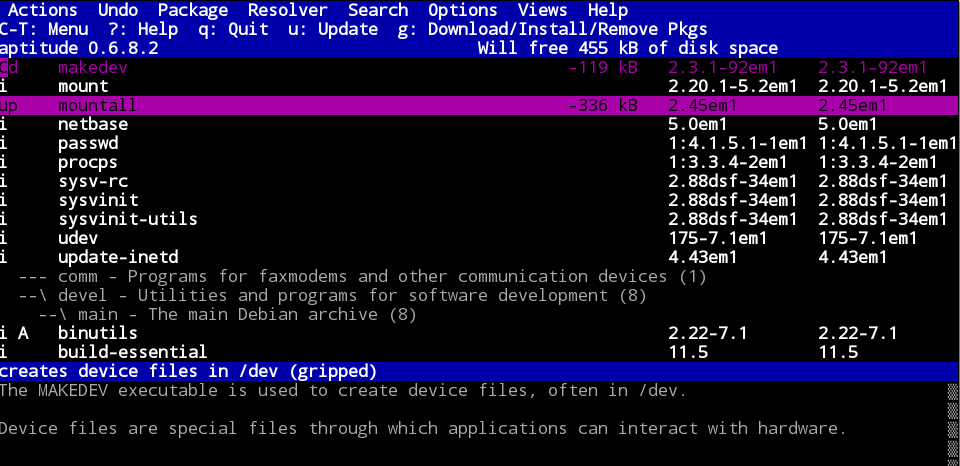

I have spent most of today trying to figure out why after a COMPLETELY clean reinstall I now get
Setting up makedev (2.3.1-92em1) ...
/run/udev or .udevdb or .udev presence implies active udev. Aborting MAKEDEV invocation.
chmod: cannot access `/dev/tty[0-9]*': No such file or directory
dpkg: error processing makedev (--configure):
subprocess installed post-installation script returned error exit status 1
dpkg: dependency problems prevent configuration of mountall:
mountall depends on makedev; however:
Package makedev is not configured yet.
dpkg: error processing mountall (--configure):
dependency problems - leaving unconfigured
Errors were encountered while processing:
makedev
mountall
E: Sub-process /usr/bin/dpkg returned an error code (1)
every time I try to install anything? humph.
Cant seem to fix it. Will wipe AGAIN. and try AGAIN bah.
EDIT: hmm. Okay so I finally noticed an error about the LD_LIBRARY_PATH not containing the right things...
LD_LIBRARY_PATH contains the traditional /lib directory,
but not the multiarch directory /lib/arm-linux-gnueabi.
It is not safe to upgrade the C library in this situation;
please remove the /lib/directory from LD_LIBRARY_PATH and
try again.
So I did (duh)... and now I managed to get the installs to work.. but this is definitely a "new" requirement.
and I still get the
A package failed to install. Trying to recover:
makedev
mountall
Warning after just about everything to do with apt or dpkg. Sigh... Will keep digging

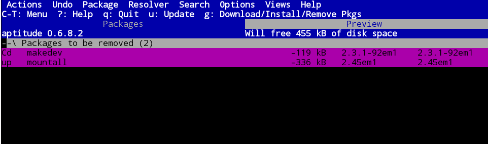

EDIT: Okay I am going to try to just remove them for now with aptitude...
(pictured)

Okay removing the apps fixed the issue. perhaps reinstalling them they will work okay now... I will have a check after I back the current image up.
Thought I should record it all anyways for the future reader.
When they said UNSTABLE they really meant it!
