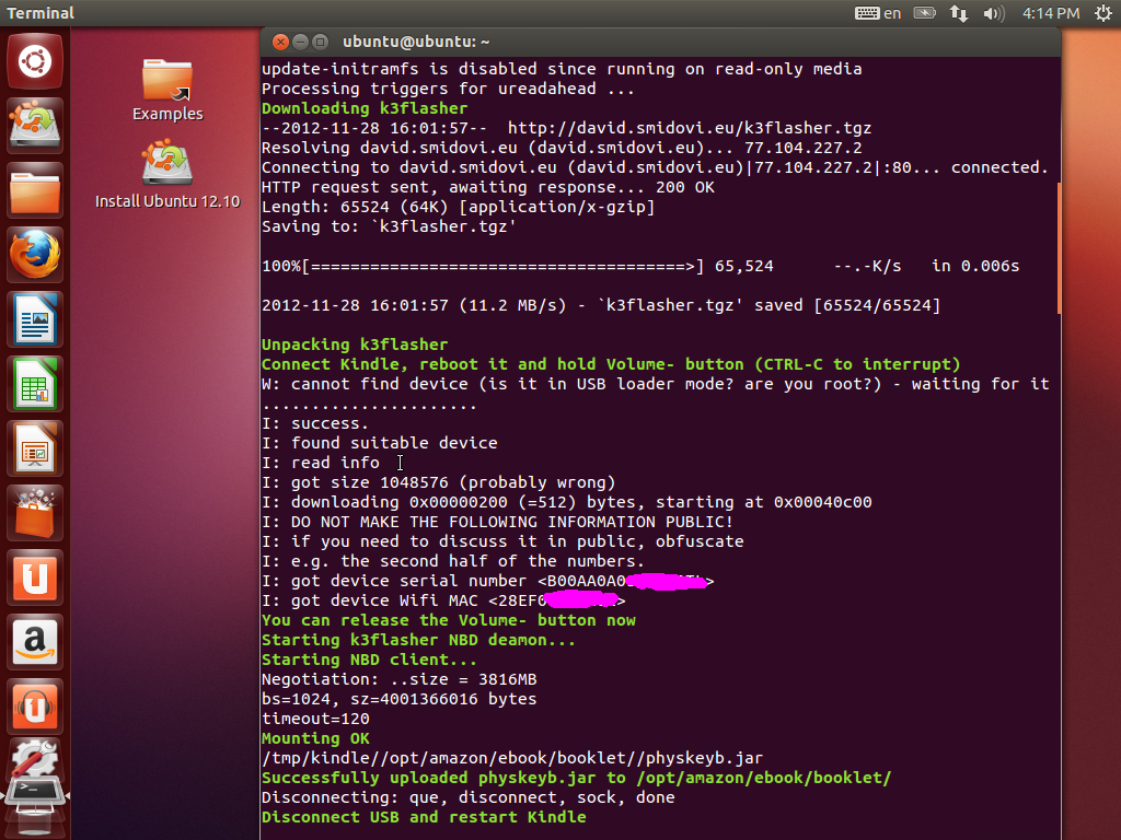

I've made a script to make the whole task simpler.
  1. Boot Ubuntu 12.10 LiveCD
  2. Click on "Try Ubuntu" button
  3. Make sure the Internet connection is working
  4. Click on the top left icon with "Dash Home" label
  5. Type "Terminal" in the search box
  6. Click on the Terminal icon
  7. Type or paste
    wget http://david.smidovi.eu/k3upload
    in the terminal window and press ENTER
  8. Type or paste
    bash k3upload
    and press ENTER
  9. Answer <Yes> in the message dialog
  10. Follow the instructions
  11. It should look like this:
