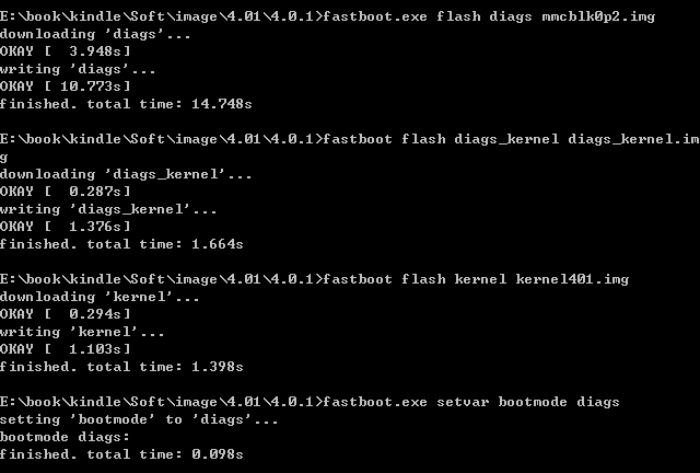

I followed the steps again to find out where I made mistakes.
1. Download and check Images(4.0.1)
2. Switch to fastboot mode
3. Flash images
4. Reboot
However, after several flashes, kindle screen still turned to total black.
Now I am charging with AC power, update later.

The 4.0.1 kernels were know to be bad (too short), and they were removed from the pastebin for that reason.
You should have better success using the 4.0.0 kernels and images... Then after removing the screensaves 800x600 file, and renaming 800x600_ to 800x600 (bad screensaver hack residue in the 4.0.0 main image), you can update to newer firmware...

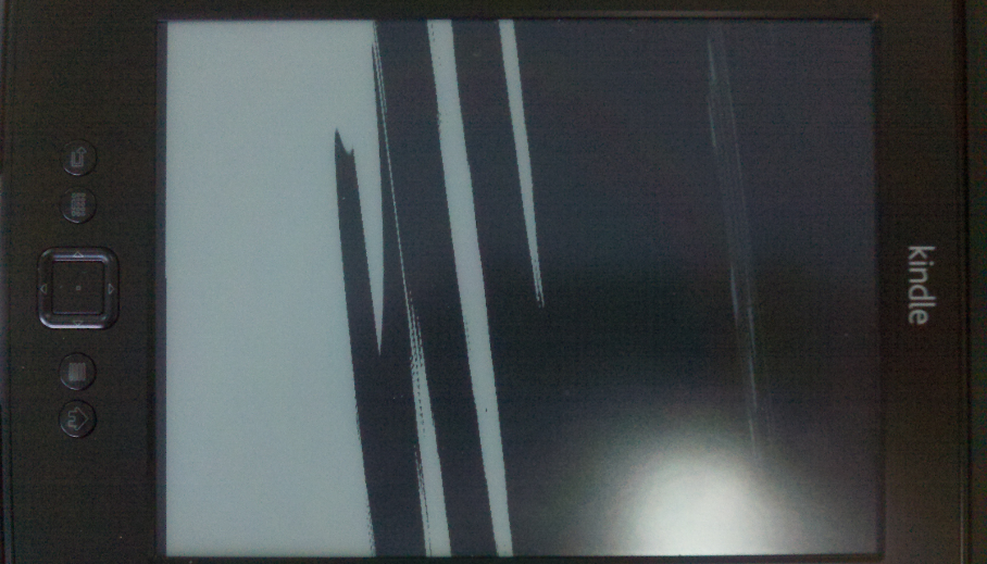

I download 3 images(v4.0) : main_kernel, diags_kernel,p2
The extracted images:

Then, flash the images:
Sequence are p2, diags_kernel, main_kernel, as shown :
Finally, the output:
nikoday is offline   Reply With Quote
Attachment 96827
Attachment 96828
Attachment 96829
Attachment 96830
With the result of showing the "Boy under the tree" screen saver image while in the "diag" mode.
Now which "main" file system image (mmcblk0p1) do you intend to use? (it **must** match the 'main' kernel)
The Kindles are "dual boot" machines, there should be two pairs, a kernel and a file system image in each pair, for a total of four files, not three.
I have not flashed p1, because I cann't enter diags mode.
The image you posted shows that you are in diags mode.
Or at least you where the last time the e-ink display was updated.
yes, I should be in diags mode, but I can't see any text due to display problem
Diags can crash like that (twisted boy under tree) if the diags kernel does not match the diags partition, or if the battery was too low to finish booting to diags.
While in diags mode, there is no screensaver or sleep mode, so the battery can discharge completely (making it appear bricked). It would be good to leave it connected to a charger (or host PC) while in diags mode.
P.S. The "twisted boy under tree" screen happens because the startup code assumes 608x800, but in diags the screen is actually 600x800. This is normal for a K4, but should only last a second or two before the diags menu appears (unless battery is too discharged).
When the charging LED turned green, I plugged it to usb host and restart, but still got the twisted image.
I am quited confused now.
I am quite confused now.
As stated far too many times in far too many posts in this forum, you cannot trust the power LED color on a bricked kindle.
Perhaps your battery is charged enough, but your diags kernel does not match your diags partition. Or perhaps your battery is discharged (which can happen rapidly if left in diags, or while frozen partially booted).
