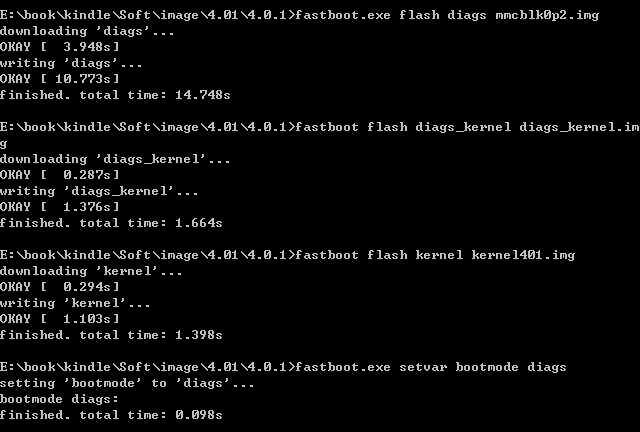

4. Reboot
However, after several flashes, kindle screen still turned to total black.
Now I am charging with AC power, update later.

Device: K1 to PW3
The 4.0.1 kernels were know to be bad (too short), and they were removed from the pastebin for that reason.
You should have better success using the 4.0.0 kernels and images... Then after removing the screensaves 800x600 file, and renaming 800x600_ to 800x600 (bad screensaver hack residue in the 4.0.0 main image), you can update to newer firmware...

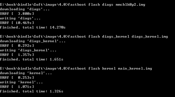

I download 3 images(v4.0) : main_kernel, diags_kernel,p2
The extracted images:
Then, flash the images:
Sequence are p2, diags_kernel, main_kernel, as shown :
Finally, the output:
Attachment 96827
Attachment 96828
Attachment 96829
Attachment 96830
With the result of showing the "Boy under the tree" screen saver image while in the "diag" mode.
Now which "main" file system image (mmcblk0p1) do you intend to use? (it **must** match the 'main' kernel)
The Kindles are "dual boot" machines, there should be two pairs, a kernel and a file system image in each pair, for a total of four files, not three.

Diags can crash like that (twisted boy under tree) if the diags kernel does not match the diags partition, or if the battery was too low to finish booting to diags.
While in diags mode, there is no screensaver or sleep mode, so the battery can discharge completely (making it appear bricked). It would be good to leave it connected to a charger (or host PC) while in diags mode.
P.S. The "twisted boy under tree" screen happens because the startup code assumes 608x800, but in diags the screen is actually 600x800. This is normal for a K4, but should only last a second or two before the diags menu appears (unless battery is too discharged).
