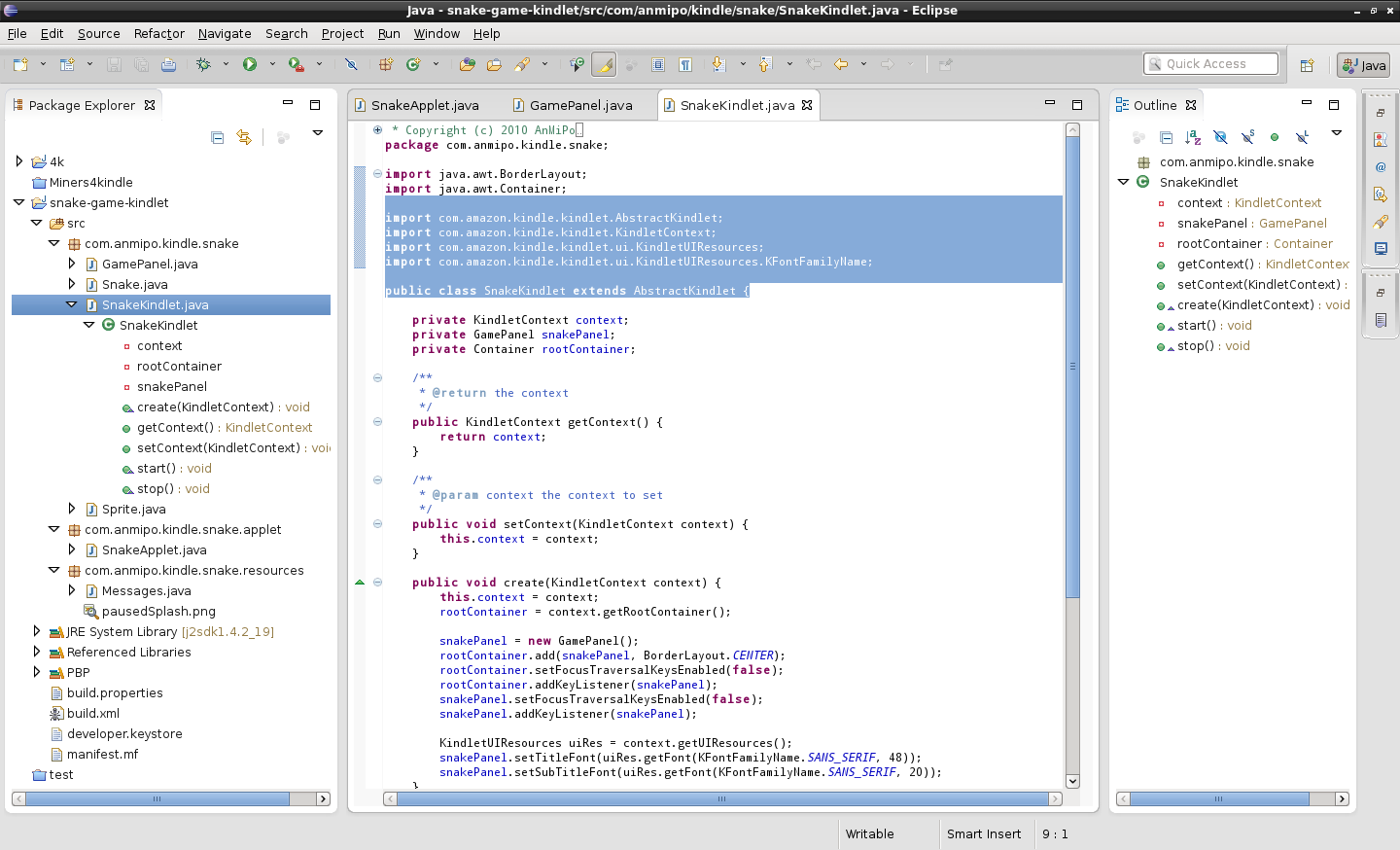

Some. Enormous. Shots of my desktop running Juno.
( I trimmed it down to one monitor wide :\ )
Perhaps they will help grease the wheels.
Good Luck.
