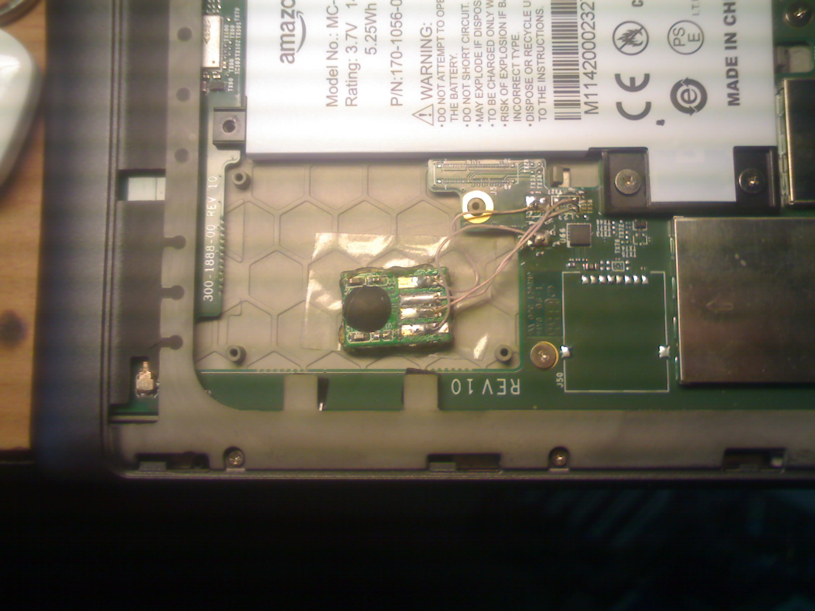

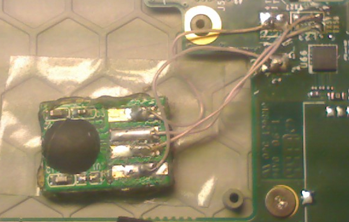

I'm create super china storage for debian. It is usb adaptor and microSD 8gb.
Supply current 40-50ma. When rmmod ehci-hcd supply current 0-1ma.
How to run rmmod ehci-hcd when the screensaver? And when you turn off the screensaver run moprobe ehci-hcd?

Excellent work. any chance of some part numbers and pinouts. I think i will give this one a go!
Superstar (I have tried looking closely at the picture )

Now how about some of those hardware details twobob asked for?
