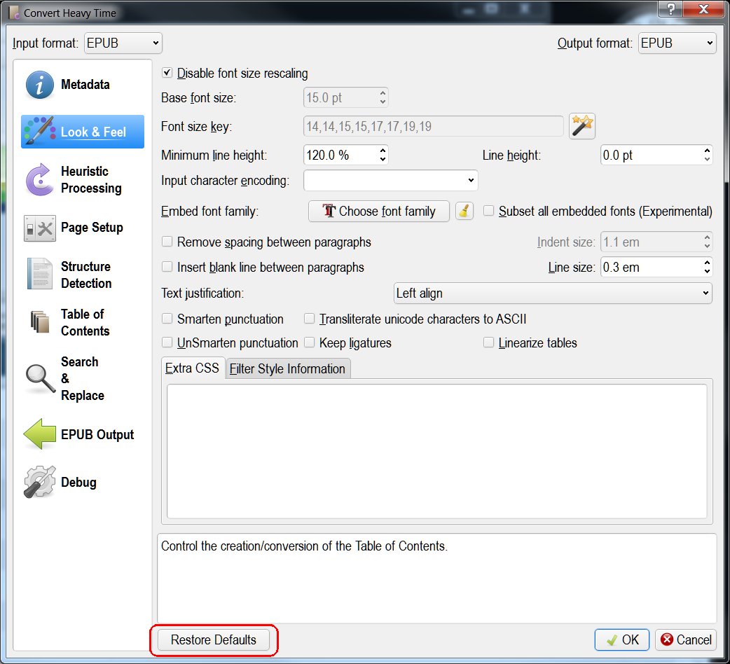

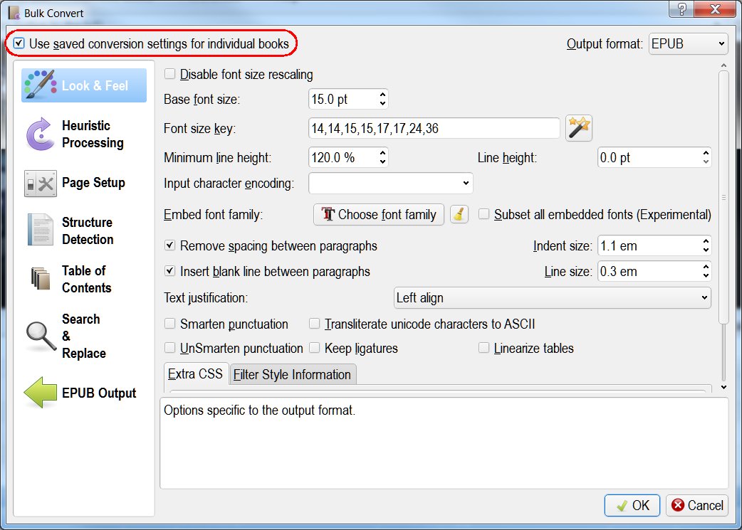

If you changed the setting to insert the metadata under Preferences - Common options - Structure detection this setting will be used for any books you convert that had never been converted before. If a book had been converted previously the previous "saved settings" would be used again. To get around this if doing a bulk conversion of many books you must uncheck the Use saved conversion settings for individual books box before clicking OK to convert the batch. Or if converting a single book you must click restore defaults before clicking OK to convert the book. See attached.

yes! yes! that's it!
and it makes sense, looking back, why one book "worked" and the others did not.
thank you so much for taking the time to help me out!
off to try bulk conversion ...
