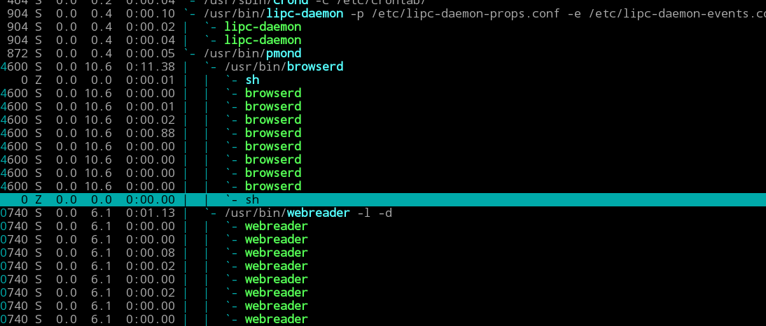

(after opening browser once and minimising)
lsof:

another viewpoint for process hierarchy
