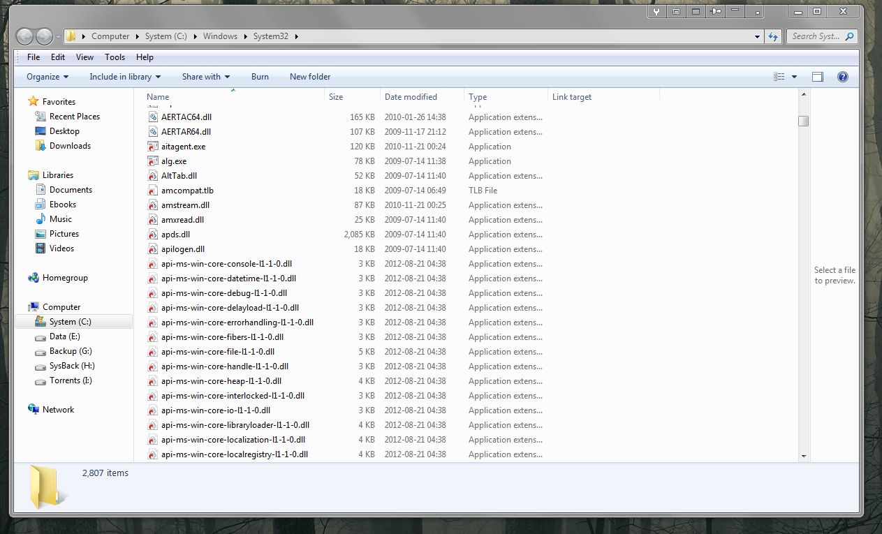

My Calibre Library is on an internal hard disk, I don't use Dropbox or anything like it, I run Calibre on a standalone system. I dont have any SSD's, or RAM Disks and the databases are within the relevant library folders and there are no hard, soft or alias links to them - i.e a vanilla, white bread installation.
The drive where I have the Calibre libraries has thousands of hardlinks (unrelated to Calibre - related to analysis of telemetry data). Some files have 1023 (the maximum) hardlinks so that I've had to create second instances of the data. I have some NTFS drives that I mount as needed in a disk dock, two of those disks also have lots of hardlinks - some of which were created under NT3.51 in 1998. They all work.
Since Vista (maybe XP, can't remember) every Windows system has Windows\winsxs folder, 90% of the files in there are hardlinks to file elsewhere, I've seen files with up to 6 links in there. And there are over 11,000 subfolders in my winsxs folder.
Even lowly notepad.exe has four hardlinks
C:\Windows\notepad.exe
C:\Windows\winsxs\amd64_microsoft-windows-notepadwin_31bf3856ad364e35_6.1.7600.16385_none_9ebebe8614be1470\notepad.exe
C:\Windows\winsxs\amd64_microsoft-windows-notepad_31bf3856ad364e35_6.1.7600.16385_none_cb0f7f2289b0c21a\notepad.exe
C:\Windows\System32\notepad.exe
I've attached an image of a fragment of my Windows/System32 directory (which is where much of Windows lives), the little red arrows you see on the most of the icons indicates that the file has as least one other hardlink somewhere.
If you copy a file in Explorer from one folder to another on the same drive, then by default Explorer will Move the file by creating a hardlink at the new location and trashing the hardlink in the old location. You have to go out of your way to actually copy the file - ie do a cut & paste or a right click drag drop and select Copy. If Windows hardlinks didn't work then nor would Windows, so to suggest hardlinks may not work on Windows is a really big call. Some programs I wrote for NT3.51 manipulate hardlinks. They are working today, and the modify date on the relevant .cpp hasn't changed for over 12 years.
I very much doubt hardlinks have anything to do with the problem I originally described. I just changed the title on 521 books - worked perfectly - and fast, 10-20 secs at a guess. How much faster than before - dunno, never did it before.
