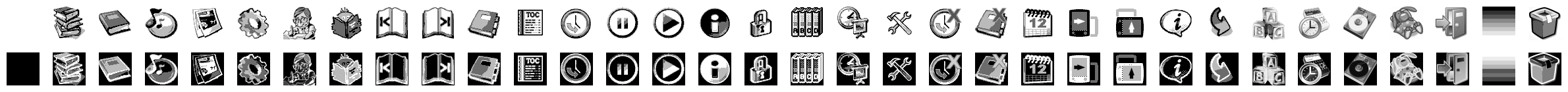

JeffElkins, look at this variation of icons to give the prscustomizer:
https://www.mobileread.com/forums/sho...0&postcount=57

If you download the software, both iconsets are in the prsfiles directory.
