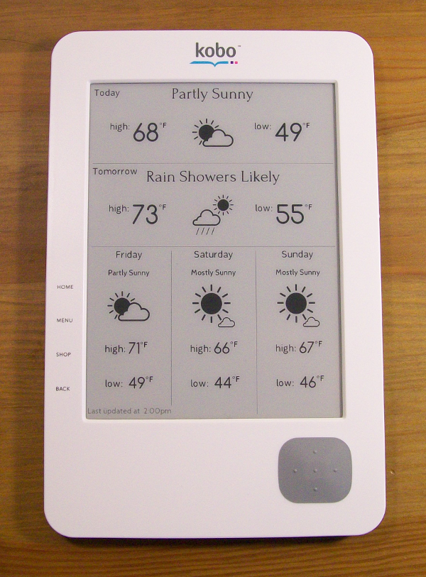

Kobo Weather Forecast - for Wifi and Touch
This project was inspired by Matthew Petroff's Kindle weather display
Update: I've changed the script to work on Kobos with a 4-bit framebuffer, as well as on 8-bit framebuffers.
Update 2: The script now uses worldweatheronline.com to get the weather forecast, so it's not limited to the US anymore.
Update 3: If you have a Kobo Touch, see this post for directions on getting this app working on your Touch.
Now that I can draw to the Kobo Wifi's screen, I just had to create something ASAP.
Presenting, the Kobo Weather Forecast!
How to install
The first step of installing is to Enable telnet access to your Wifi.
After that's done, download the weather forecast installer and copy it to the .kobo folder on your Wifi. Eject your Wifi from your computer and wait for your Wifi to install the package. It'll take a couple of minutes.
Once your Wifi has finished installing and has rebooted, telnet in to your Wifi
telnet YOUR_KOBO_IP
Now, through telnet, run the command:
/mnt/onboard/.python/install-python.sh
This sets up python and pygame. Now you can use the weather forecast! just run:
/mnt/onboard/.python/weather.sh
On the first time you start the app, it will ask you for your latitude and longitude so it can get weather info for your area. After that, you should see the weather forecast on your Wifi!
By default, it does not automatically update every hour. If you want it to auto-update, run the following command:
/mnt/onboard/.apps/koboWeather/autoupdate.sh
If you would like the temperature to display in Celsius, just change the "F" in the file "unit.txt" to a "C". If you connect your Kobo to your computer, you can find unit.txt in ".apps/koboWeather". Or you can edit it through telnet:
echo C > /mnt/onboard/.apps/koboWeather/unit.txt
Enjoy!

Originally Posted by lst View Post
Looks like some of them have a 8bpp interface to 4bpp hardware, with the top and bottom 4 being the same.
I'm **way** out of my depth here (decent on Python but embedded Linux - ) but if there's any way I can help sort this for those of us with these devices let me know.
Edit: looks like there's more detail on the kindle buffers here.
Thanks for the links, I'll take a look at them tomorrow. Saves me some time having to search for them.
And I have absolutely no experience with embedded Linux myself outside of my Kobo work.
I'm just a high school student who likes to fiddle with stuff.
Out of interest, I saw the weather app makes a call to update the e-ink after the final pygame call - but did pygame itself need modifying to talk to a / the Kobo's framebuffer?
Nope, I didn't modify pygame at all. It already has support for framebuffers, so getting
it to work was just a matter of compiling python and pygame in a virtual machine for ARM.
