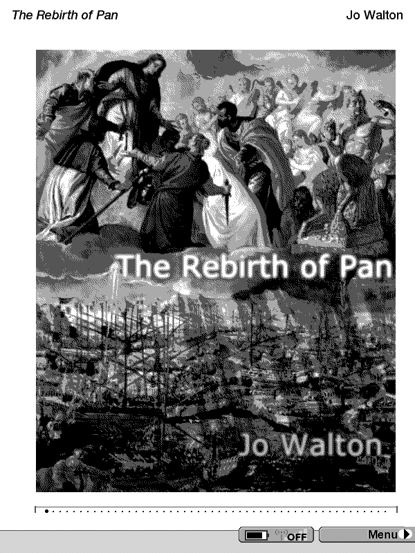

Would someone with a Kindle please give The Rebirth of Pan by Jo Walton a try to see if the graphics work please? The cover image is 500x615 and I'd like to know if it works. Thanks.
https://www.mobileread.com/forums/showthread.php?t=27146
It looks great!

Originally Posted by wallcraft View Post
The rules for MobiPocket Creator are different from Amazon's DTP (which seems to be sub-optimal for images). See Kindle Automatically Doubles Image Sizes.
As you can see, a Mobipocket eBooks I have created with a cover image of 500x615 works fine on the Kindle's Mobipocket Reader. So why is it that DTP wants such small images?

It looks great!
Thank you. I'm glad it works.
