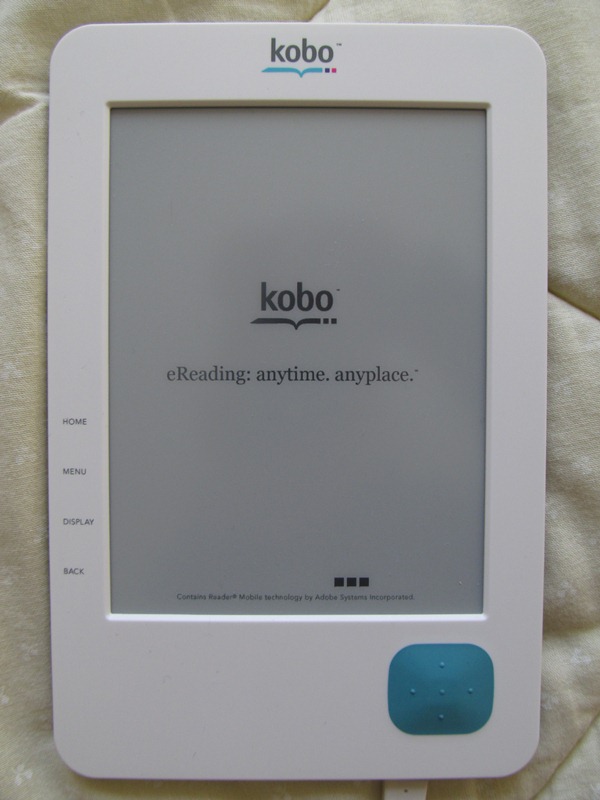

Hello, I have the same problem as SUS, but my Kobo Original (non wifi) won't charge neither with ubs nor with wall adapter. This happened after I've done a folder method upgrade tentative (I wish I didn't do that!!) and I can't do anything with my ereader: no usb access to folders, no power, no charging.
This is my situation:
I hope that somebody could help me ... thank you,
Claudia
What were you upgrading to? There hasn't been an upgrade for the Kobo Original in a long time, and if you tried with a version meant for one of the newer devices you may have bricked it . I can't remember what the sequence to manually start a factory reset on the KO, but if you search the forum you may find that info. Good luck.

Thank you for replying robko, I've found out that I couldn't do the upgrade after doing it! I can't do any kind of reset because the KO doesn't charge ... I would like to access the device to fix the problem but I don't know how to do it ...
