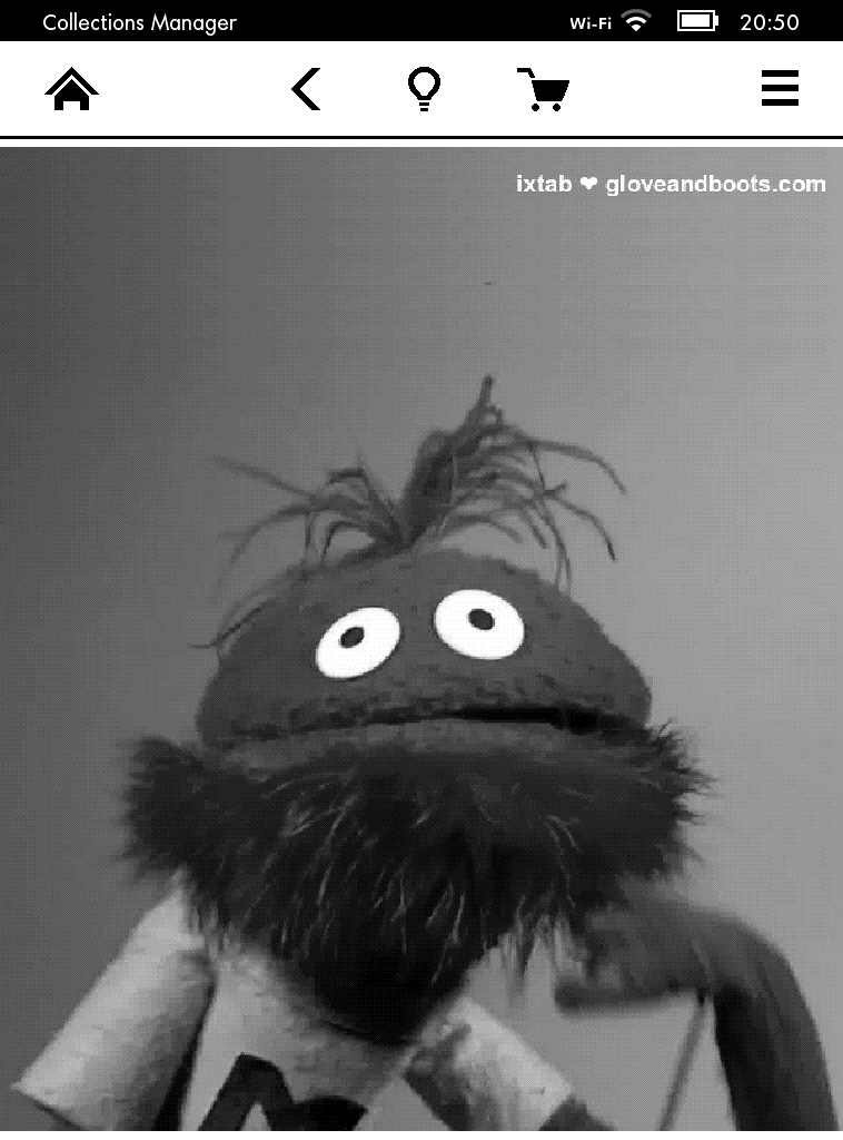

To trigger the easter egg, just try to hide the Collections Manager from Home.
  • The actual easter egg is that Collections Manager will refuse to hide itself - instead, it will show a nice image of Mario (also see the "Totally Off-Topic" part of the first post to understand why you just have to love this puppet). To trigger the easter egg, just select (only) the Collections Manager, and press the "toggle visibility" button.
  • There is actually a serious background to this: if you hide the Collections Manager from the home screen, you will normally not be able to access it anymore. This is why it refuses to hide itself.
  • The workaround - if you really, really want to hide it from Home - is to put the Collections Manager inside a collection.
So... does the easter egg display correctly on the PW?
ixtab is offline   Reply With Quote

Yes, Mario is here !

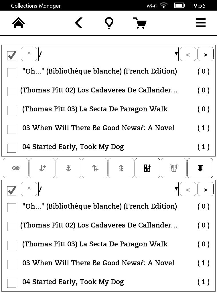

here also a screenshot of the Collections Manager on the PW.
You will also be glad to know that the Calibre Collections Plugin now works perfectly well (as far as I can tell) with the importing function
Do you want other screenshots ?
ID:	93774   Click image for larger version
Name:	collec Manager.png

The first pic is how to get to see Mario's sweet face. the second is the menu, with only the export to calibre missing but it is at the end of the choices if you scroll down
ID:	93776   Click image for larger version
