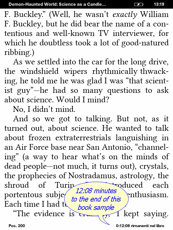

Reading timer hidden feature (Kindle Touch with firmware 5.1.2)
Eureka has found a disabled Kindle Touch 5.1.2 feature which seems to be used in the latest Kindle Paperwhite model announced by Amazon (advertised as "Time to read"). He noticed that in /opt/amazon/ebook/config/reader_plugins.xml there's a commented plugin called Reading Timer (located in /opt/amazon/ebook/lib/ReadingTimer.jar).
Well, I uncommented the plugin and restarted the framework and ... It seems to work.
When you open a book, in the menu you find a new item "Activate reading timer" (already localized in IT, DE, FR, ES, ...).
After a first phase of "training" the timer begins to work. It gives (on the status bar) a projection of how much you have already read and how much you miss to the end of the book even if I don't know how accurate it is.
The initial training can be reset by removing the reading preferences file (warning: also font and margin preferences are reset, and the introductory page teaching how to turn pages is shown again once).
You can tap on the status line ad the bottom of the display to switch between different infos (time elapsed since beginning, time to the end of the section and of the book).
For more screenshots see here.

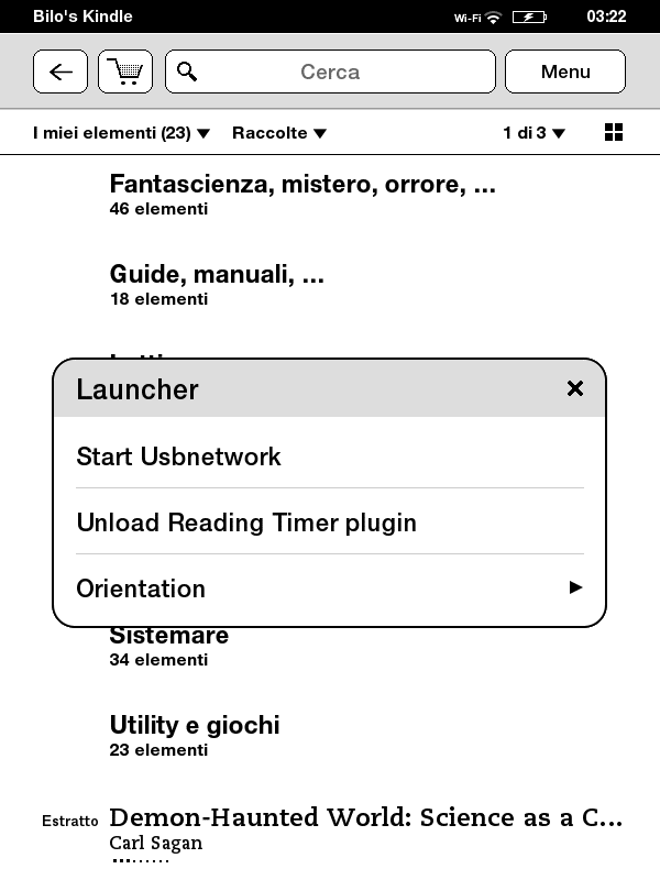

Reading timer launcher extension
Implementing a "Launcher" extension to load/unload this plugin is quite simple: remove comments from the appropriate line in /opt/amazon/ebook/config/reader_plugins.xml file or set them back and then restart the framework.
Prerequisites:
  1. Amazon Kindle Touch with firmware 5.1.2 (maybe 5.1.0 is OK, but I havent checked)
  2. Jailbreak
  3. GUI Launcher for Kindle touch.
To activate the extension, unzip the files in the extensions directory. A new "readingtimer" subfolder should appear, containing a shell script in readingtimer/bin which does the trick.
Warning: This extension has been tested only on my 5.1.2 kindle touch. Don't use it on different firmwares and in particular don't use it with firmwares from 5.3.2 on (it's no longer needed and could damage your KT). In any case don't use it unless you know what you're doing. Do a complete backup before trying since it could damage your kindle.
After tapping on "Load/Unload Reading Timer plugin" you will see your display turn white. Wait until the framework has restarted.
At the end of the book menu (that which pops up when touching the top of the display) you will find an "Activate reading timer" entry. Tap it and the plugin will start counting time. «At this moment, 3h 45m at the end of the book I'm reading and 10 minutes to the end of the section. I've enough time to read the section to the end and maybe I'm going to finish the whole book within tuesday». ;-)
This extension has been tested only on my 5.1.2 kindle touch. Don't use it on previous firmwares and in any case don't use it unless you know what you're doing. Do a complete backup before trying since it could damage your kindle.
To install:
  1. connect your kindle to the computer;
  2. open the extensions folder (if it's not present, you're missing point 3 in prerequisite list);
  3. unpack the contents of the readingtimer-vX.Y.Z.zip file directly to the "extensions" folder on your kindle.
  4. unconnect the kindle;
  5. restart your kindle;
