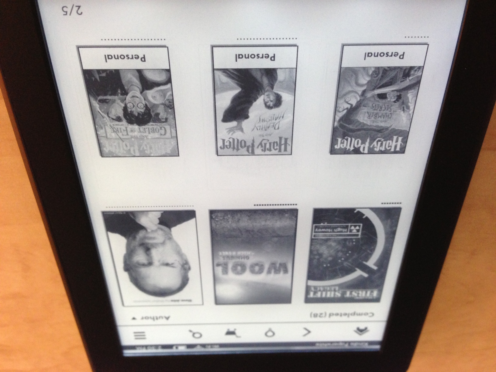

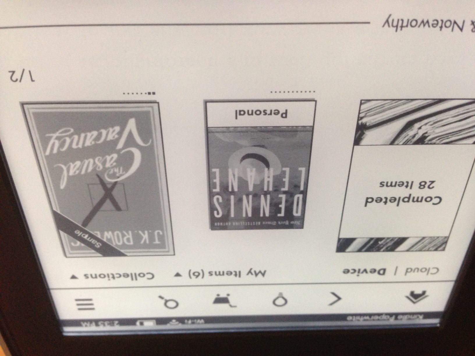

I'm having a (very picky) issue with my personal AZW3 titles on my new Kindle Paperwhite. For some reason the covers show up at about 60% of the size they should be showing up on the device. I have the "enable sharing" box checked on the output settings since it doesn't show a title if it isn't checked, and I tried checking the "disable compression" box thinking it might be shrinking the cover image. That didn't do anything. MOBI files do not do this. If I export the same book using the MOBI format, the cover is the full size (but I lose my formatting options). Does anybody have any suggestions? I attached an image just to show what's happening. In the second image, if you look hard enough you can see the ghosting around the bottom three books to show how large they're supposed to be. Thanks!!
EDIT: Ugh. Sorry for the upside down images. I don't know why that happened. But you can still see the problem.

I *think* Calibre's simply embedding/pointing to a thumbnail that's simply too small for the higher res screen of the PW.
I'll look into the whole cover shebang once I get my PW (in... a while ).

Yup, Calibre was fixed a huge amount of time ago. It now does the right thing.
If you get a small thumbnail, you probably have wonky conversion settings. (OTOH, it would take no ASIN (ie. enable sharing over FB & co *checked*) on an old mobi7 to cause the Kindle to pick the thumbnail embedded in the file, which, yeah, is slightly too small on the PW. Unfortunately, Kindlegen still generates tiny embedded thumbnails too, so we're following suit, and assuming there's a reason for this (backward compat?)).
