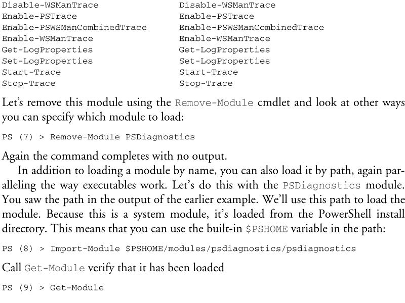

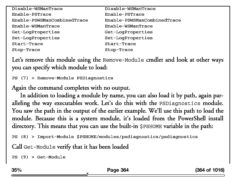

I've made two screenshots: one for default Kindle 3 (Keyboard) PDF reader and one for this one. You can add these screenshots in description to illustrate difference (and improvement) between readers.
ID:	93630   Click image for larger version
