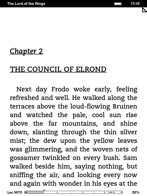

I am quite sure. I did a screenshot before and after. The biggest changes are "a" and "e" that are clearly different.

Just tried the uninstall method and it worked. So /fonts and ;fc-cache is ideal for updating the default font to a new version.
This time used the default names: Caecilia_LT_65_Medium.ttf, Caecilia_LT_66_Medium_Italic.ttf etc. and it worked Thanks for this method!

17:10 is 5.40 from K3/K4 latest patch, 17:16 is the lastest in Touch 5.1.2 - that is v5.00 beta of Caecilia font.

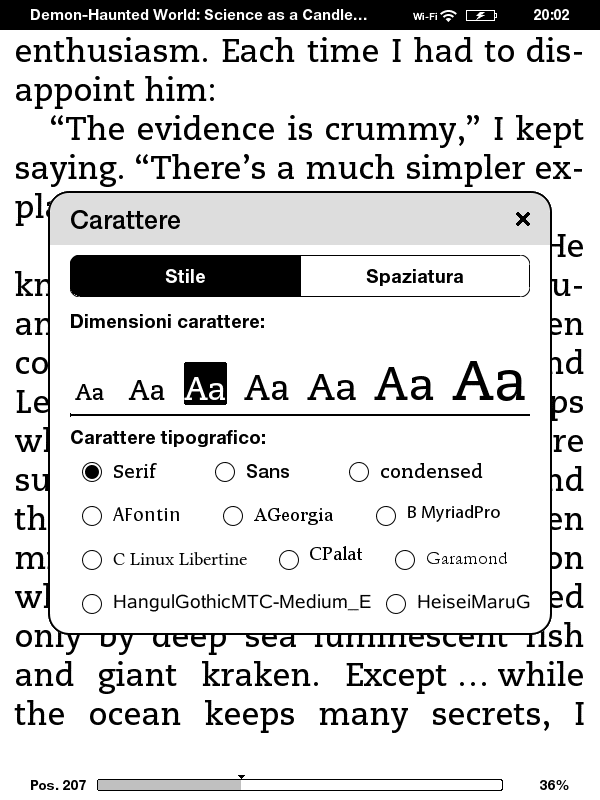

I noticed just now what I suspect to be a very interesting side effect of your font size patch.
I've added custom fonts using the USE_ALT_FONTS + ;fc-cache simple hack.
With your patch I've reset font sizes removing those unuseful EXTREMELY-LARGE setting.
In the Aa dialog, after the line with official fonts, there are now THREE lines for custom fonts instead of two. I guess that being the font size line shorter, there's more place for listing custom files.
Wouldn't it be possible to set the height of the "Aa" dialog?
