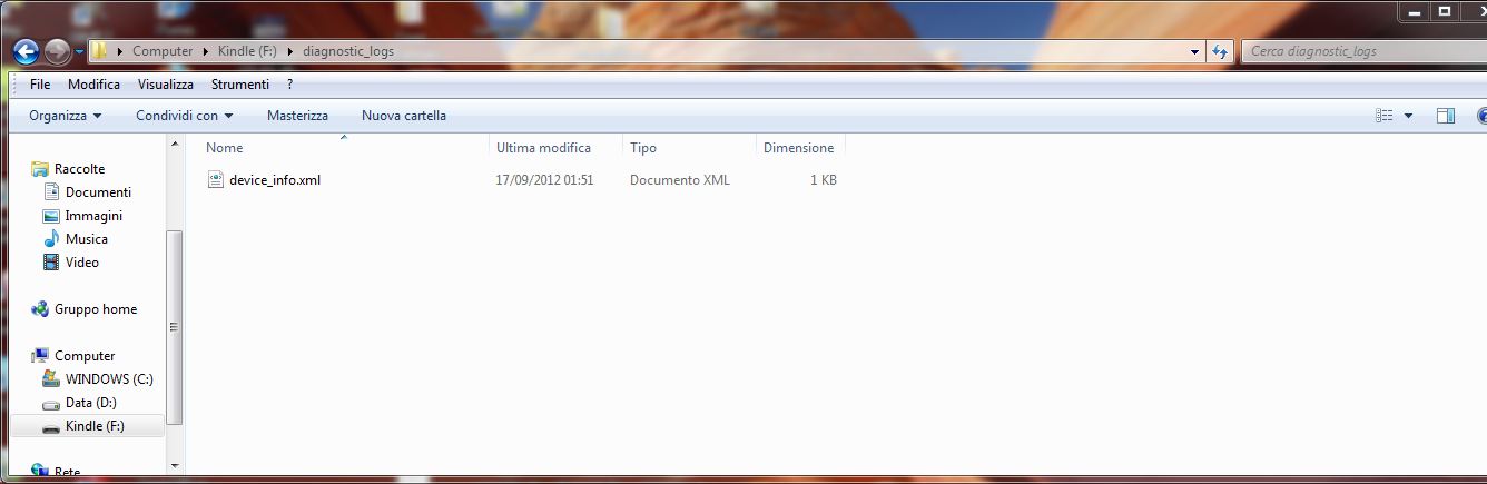

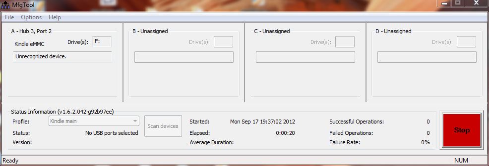

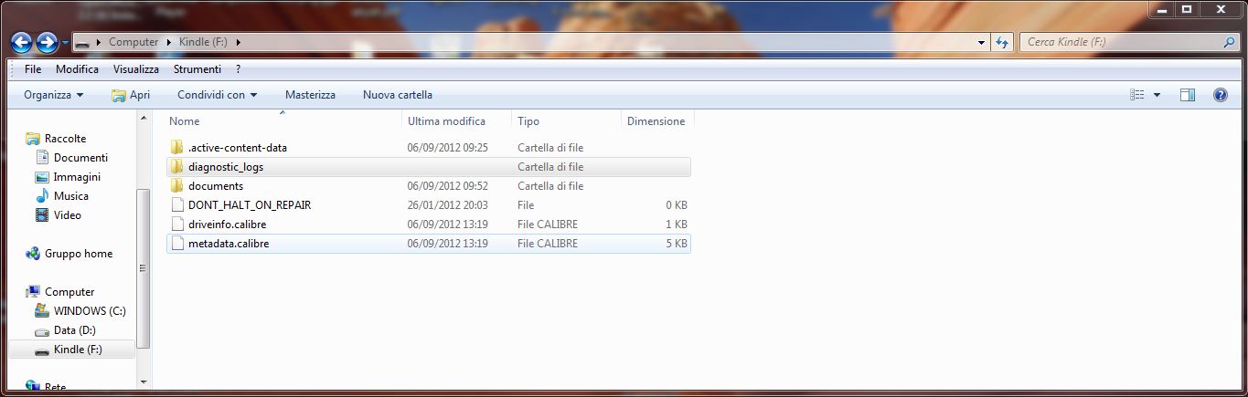

Ok, I made three screenshots to clarify the situation for you guys.
1) The directory F:\ : as you can see there is no ENABLE_DIAGS file.
2) The directory F:\diagnostic_logs : there's the famous file I created (and which I copy there everytime after I reboot the kindle).
3) The MfgTool: well, I selected the USB port of the Kindle in the "Configuaration" menu and then I picked the choice "Kindle main" and then clicked "Start". I tried a few times, waited for a long time and nothing happened so I just closed. Is it supposed to be that lengthy?
Your screenshot indicates that you're not booting the kindle in USB downloader mode, so the MfgTool can't work. Not sure what the key combination is on the K4 to get it into usb downloader mode - look in the simple debricking thread or any related howtos.
ixtab is offline   Reply With Quote
5-way down button.

hmm. from memory.
Push powery thing.
wait. ( 20 seconds according to the Amazon website)
BEFORE RELEASING powery thing. Press DOWN on 5 way.
Release power button.
screen stays blank IIRC. (I used this on a k3 with K3Flasher)
CAVEAT: I have never actually done it on the device type, but that sounds about right. HTH
@geekmaster: I don't know what you mean by "5-way down button": when should I press it, inside which menu? I really appreciate the help, but since I am no developer or computer expert of any kind it'd be much easier for me if you were less cryptic (probably to you it's the most natural thing but trust me, to me it is not).
*sigh*
You are not expected to be "a developer or computer expert of any kind" - but you ARE expected to read the documentation. I even told you where to start looking for it: the "simple debricking" thread. In that thread, you find the following statement:
Follow the instructions in the "Select Boot" thread to get your bricked kindle into fastboot mode. [...]
This is documented in the "Select Boot" and "Fastboot Manifesto" threads (see links provided below).
... and a link to the thread, where you find this:
To get your kindle touch or k4nt into USB Recovery mode, plug in the USB cable, the press and hold the power switch until the power LED turns off, then press and hold the "Magic Key", then release the power switch, then release the "Magic Key". The "Magic Key" is a special button that is different on each model of kindle, and is used to enter USB Recovery mode.
Kindle Model, Magic Key:
Touch, Home button
K4NT, Five-Way Down button
