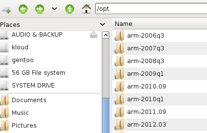

I have several TC's installed for the purposes of testing following this excellent - painless - method. (PICTURE ENC.)
