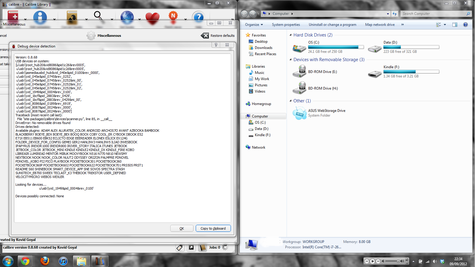

That log does not show any drive as being recognised by Windows! That is a bit strange if you say it is being recognised and assigned a drive letter by Windows.

picture attached
Yes, very strange.
Name:	kindle evidence.png

Since windows is telling calibre there are no removable drives, there isn't anything calibre can do about it. I suggest you use the connect to folder function to connect to your kindle.
