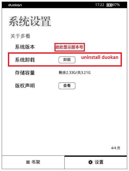

it is on the 4th page of the settings:
Name:	uninstall duokan.jpg
Attachment 92218
I think that I tried it, but it didn't work. But now it's too late for me .
Anyway thanks for your help. Maybe it would be useful for someone else.
