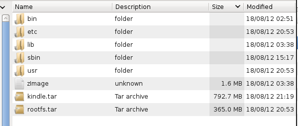

me@dev ~/BLDS/temp $ tar -c -h --hard-dereference -l -f test.tar ./bin ./etc ./lib ./sbin ./usr
tar: ./sbin/mount.ntfs-3g: File removed before we read it
tar: ./sbin/mkfs.ntfs: File removed before we read it
tar: ./sbin/mount.lowntfs-3g: File removed before we read it
tar: ./test.tar: file is the archive; not dumped
tar: ./etc/resolv.conf: File removed before we read it
creates the tar we need. (with the omissions outlined above) when pointed at an untarred copy of the rootfs.tar. So perhaps an interim 'expand' and recompress stage will be required.
In my experience the growth factor is between 200-250% given the task I am discussing.
: ) Glad we are doing this.
Thanks for the qt tip. I'll go dig. Qt really was my raison d'etre underlying this. it would be sexy to get the new release (when it makes it in) compiled using the super compliant tools. Probably a complete pig to get it to swallow but worth it I would wager.

as a finger in the air. I think I under estimated the swelling - I just tried it with a large usr/lib dir (from building stuffs)
a 104 MB rootfs.tar become 390MB (since the usr/lib swells so much) possibly hardlinks could be a solution if the file swell does become an issue...
I'll cram a whole load of junk in a build and see what happens.

Original Tar - With a whole pile of stuff in it... 365 Mb - for everything other than those things I listed.
The qt demos are 20GB for the record. No really.
simon@dev ~/BLDS/buildroot/images $ tar -x -h --hard-dereference -l -f rootfs.tar ./bin ./etc ./lib ./sbin ./usr
(makes the file structure pictured)
simon@dev ~/BLDS/buildroot/images $ tar -c -h --hard-dereference -l -f kindle.tar ./bin ./etc ./lib ./sbin ./usr
Results in a 792 Mb final delivery file. - So I was right about 200 - 250% when it starts to even out with bigger numbers.
Oh and there is our script - happy days.
