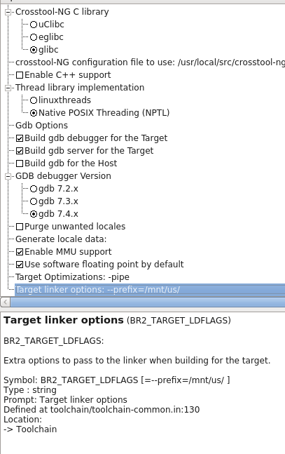

@twobob: Note that a fully static host toolchain and fully statically linked target binaries are two different beasts. (By 'host' I'm referring to our native Linux distro or whatever you run your TC from, and 'target', the Kindle)...
Heh yeah I see my basic error. Still the principle is mungleable into the same Venn diagram : )
I think I do really want the ability to generate fully static bins going forward and I am going to try out the Crosslib-ng route via buildroot. why not : )
It has a custom skeleton that I am playing with getting something like and once I figure how to splat SYSROOT or/and --prefix / LD_LIBRARY_PATH and anything else I don´t know about yet but really need into it I will look into creating some tools that eventually free us from the need for it.
I´m into my nth (read over 20 30?) incorrect build of my tools but never let utter failure get you down I always think.
the flameeyes links I posted I hoped might provide the correct interim measures that could be a) applied to re-purpose the binaries created during the configure stage for the correct load paths for our target and then b) further process used to correctly seat the resultant created installs into said paths created by fs/skeleton.
True the configuration details are buildroot specific and perhaps no-one can help who hasn´t used it but that doesn´t stop me asking here, and of course continuing to dig on the buildroot site itself.
At least I didn´t embarrass myself by asking the question I was going to ask about x-compiling that had a known solution. I´m trying to save up my questions on that mailing list for the really important stuff. Should we find some. My inability to set basic compiler flags doesn´t qualify. Please someone point me at a man page and hopefully a guide? @___@
One would imagine the section marked PreProcessor Flags (The only section with any such argument entering capability) would be the one to splat stuff at. but --prefix=/mnt/us seems to go ignored - even with the relevant skeleton in place. Clearly PEBCAK.
Sigh, I wish I knew more so I can get stuff done faster, I would be of more use. Still that´s what this whole life thing is all about I suppose.
So yeah. Thanks for the tips. If anyone has a dumbasses guide to splatting stuff into the configures / compiler / etc that would be great. I´ll be pillaging Google in the meantime. Perhaps in the next couple of weeks a day could go by where I don´t have to learn a new skill.
Perhaps.

@twobob: Well, unless it's targeted at the wrong arch or potentially CPU/FPU, yes .
I have a whole host of great things here if I can just get the flags passed either at the beginning, during the process, before they install. Or all three.
--prefix=/mnt/us SYSROOT=/mnt/us LD_LIBARARY_PATH=/lib:/mnt/us/lib etc... Kinda thing.
Any clues what I should be reading. Don´t tell me, the man page right.
Anything a bit less sober out there? anyone : D
More specifically: how does one pass all that info into this ridiculous tiny box
answer I suspect is - you don´t

If you're adventurous like me, you *can* use a newer GCC/glibc pair (I'm using Linaro GCC 4.7/glibc 2.9 for my k2/k3 tc), but know that you might have to tweak some C stuff/trick autotools to avoid pulling stuff from newer glibc, and that C++ stuff will probably be a no-go unless you're willing/can statically link libstdc++. (And you'll have to kill gcc's ssp and glibc's fortify support, which is usually a simple matter of correct CPP/CXX/CFLAGS).
Using incremental linking stages in the overall construction of a run-time object can accomplish amazing things.
Some Makefiles are constructed to do that from the ground up (usually for very large applications), most small application Makefiles do not have that organization.
But this is hardly a software 101 build subject.
Shoot, it isn't even a Makefile 101 subject.
On a related topic (no pun intended) . . . .
Someone wrote a dynamic loader wrapper that allows you to run more than one loader/libc on the same machine.
I.E: at object load time, it checks the elf header, then uses the appropriate dynamic loader.
Translation: You can install and run uClibc linked applications on a glibc system.
