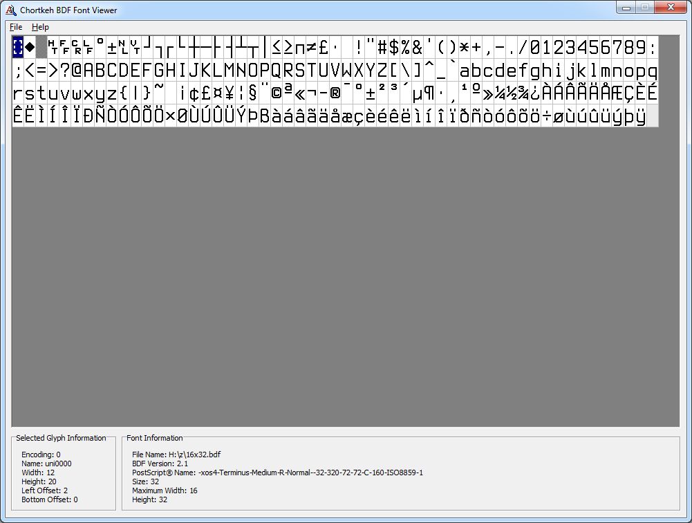

The .bdf font appears to be quite valid:
Name:	Chortkeh BDF Font Viewer.jpg
As you pointed out, the perl script produces uneven length definitions of the glyphs (hence faithfully recoding the input -- this is *not* incorrect IMHO).
It is the myts code that appears to only expect even lengths. Probably easier to tediously recode the source bdf using fixed 16x32 bitmaps.

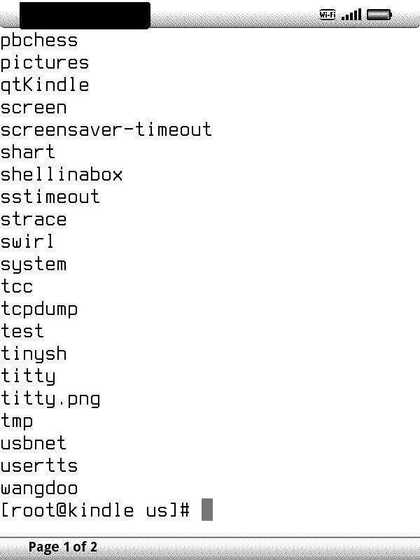

Enjoy, Click image for larger version
ID:	90651 and thanks for the karma!

Originally Posted by PoP View Post
I was too lazy to make one, so I found this one. This font is overkill having too many unnecessary glyphs but its insanely big 16x32 pixels provide a 37x25 terminal window. Most importantly the glyphs have fixed width for easy integration in myts.
Enjoy, Attachment 90651 and thanks for the karma!
Excellent. Your ini appears to be truncated though?
I thought they ended:
ScrollbackLines = 1000
LangSymbols = .
LangSymbols16 = .ץקךא˜•Ÿם׀ש“’›ע™—œšף–ס‘”* ž׊ת
Anyways Ill go test now. : D

Also I cant get the font to work? gah. fiddling now.
HEH: If yours is working perhaps I should truncate mine! lol
EDIT: Thats more or less straight from the myts8 above with your bits in (unworking my end might I add)
