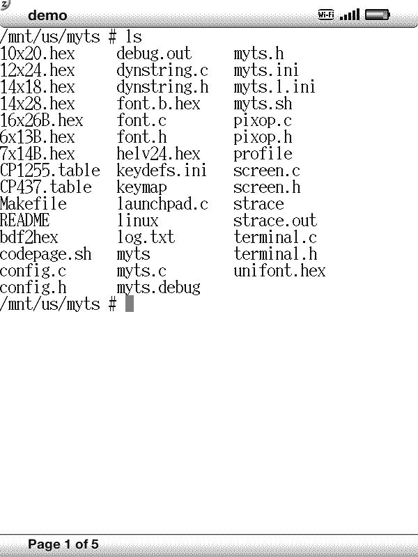

12x24 for we older awesome people's
Originally Posted by astropeak View Post
I created two fonts myself, 14x28 and 16x26. The two fonts are created by double each binary bit of the char bitmap of the font 7x14 and 8x13, and also each horizon line of the char bitmap is doubled.
but when using these font, the terminal can not be started. After I press the key "Shift T T", a message "success!" echoed on the bottom of the screen, but the terminal don't popup.
Is this font right? or the program's issue.
I got your fonts to run. once. and never again. just bombed.
And since my buddy Will18 don't dig the mini-squinting here's my effort
A working 12x24 font that is not utterly without use. : )
Tested as working on myTs 7 Kindle 3.x
Henjoy, Chars.
EDIT: correct formula was bdf2hex blahxblahFont.bdf > blahxblahFont.hex

After a far too large amount of faffing I am unable to get a larger font to convert satisfactorily (read: 'and get MyTs to start')
so that's your lot for now. The Terminus 16x32 simply refuses to play ball. ho hum.
Since the toppost still refers to 6:
Here is the reference to VERSION 7
It's not that the MyTs version is incorrect.
It's simply I get unexpected output from the converters for certain bdf's and
this coupled with some slightly 'moody' myts behaviour for biggie fonts makes the job that much harder.
I'm loath the write an entire custom font for the sake of a few pixels. : )
24x16 will have to do until I find something better
(16 width only works under myTs 7 as you correctly advise)
: ) Thanks

Up to version 7 font height was arbitrarily limited to 24 pixels. You can try version 8 uploaded now with this limit raised to 32 (the debug binaries I sent you, twobob, also had this limit at 32, which might explain why it worked once and then stopped. Version 8 is completely untested by me.
http://my.svgalib.org/kindle/myts-8.zip
