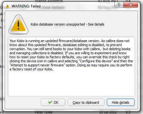

This is a screen grab of the calibre message. First time I've tried adding an attachment so hope it works. It seems you have to click on it to make it big enough to read. I think this problem has been discussed elsewhere but only suggestion seemed to be to a factory reset.
I don't want to do that since it was working ok with previous versions of calibre.
Surely if I can uninstall calibre completely , that all files, folders, etc, then reinstalling it like its from new maybe it will work again ?

That is not a 'Fail' message, but a warning/advisory that Calibre has discovered that there now exists a known condition that would require you to perform steps on your device if you want full calibre functionality again.
Read the instructions very carefully and decide if you want to proceed with the optional.
IIRC If you do not, Calibre will still send books, but little else will effect your Kobo

The point I am trying to make is that my Kobo ISN'T running updated firmware/database as it hasn't been conected to the Kobo Desktop program (which is how it is updated) since before the new Kobo firmware was released.
It has been working quite happily with calibre 0.8.61 or 0.8.62, it's a bit difficult to sure exactly which one I was running when I last connected them together.
If I can remove all the elements of calibre from my PC then install say 0.8.60 so it's like a first time intallation hopefully it should work.
I looked at Preferences - Misc. and clicking the bottom( ?) button took me to "Roaming" that has a calibre folder in which there are a whole load of files !
Are you saying these aren't removed when calibre is uninstalled ?

Calibre says that your firmware is newer than the driver supports.
It's not hard to say. I believe the last time you could have connected to calibre an not have gotten that warning when connecting was version 0.8.59, because that warning was inserted in 0.8.60
Release: 0.8.60 [13 Jul, 2012]
Bug Fixes
  • Kobo driver: Do not perform write operations on the Kobo database if its version is newer than the latest version the driver supports, for safety
As theducks stated calibre will still send books to your device fine. I think the auto-metadata management may not work because for the safety of your Kobo's database calibre will not write directly to it until the driver is updated.
If you wish to return to version 0.8.59 simply download it from Sourceforge. Find the calibre directory that has the calibre.exe file and delete that folder then execute the msi file downloaded from sourceforge. Since there is no major calibre database change it is just that simple. There will be no orphaned folders or files doing it this way.
Failing that I have to use ADE to load my Kobo with books until Kobo have fixed their firmware and calibre works ok with it again...
As stated previously your Kobo will work fine with the latest version of calibre. It will work exactly as every eReader works with calibre except for what was stated in the warning. You may have to update collections and delete books via your device.
Personally if I had a Kobo I would be using the latest version of calibre because a fix for showing Kobo books on device was included. Additionally you wouldn't be chancing possible corruption of the database on your Kobo.
Release: 0.8.63 [02 Aug, 2012]
Bug Fixes
  • Fix regression in Kobo driver that caused the on device column to not be updated after deleting books
Good Luck.

Incidentally, I get the exact same error with a Kobo Wireless (version prior to touch) that hasn't had a firmware update in ages. Deletes always worked fine before. I'll probably go the route of configuring the device to attempt to work with the "newest" firmware just to get back to where I was.
camiller is offline   Reply With Quote
Old 08-06-2012, 08:47 PM   #15
davidfor
Posts: 24,905
Karma: 47303828
Location: Sydney, Australia
Looking back through the thread something hasn't been mentioned:
There have been no changes to the code of the Kobo device driver in calibre that affects the actual function since before February of this year.
The change being discussed here is a simply a warning. This was put in on the 7th of July and went into calibre version 0.8.60. It tests what database version is found on the Kobo device and compares it to the versions that the calibre driver understands. The driver is coded for up to database version 33. Unfortunately, no one has been keeping this up to date. But, luckily there had been no changes to the Kobo database that caused any problems.
I don't know exactly what firmware version DBVersion of 33 is from. From my Kobo Touch, I have copies of the database from various times. I have one from when I recently did a factory reset the device. It has DBVersion 29 for firmware 1.9.11. I also have DBVersion 36 which I came from either 1.9.14 or 1.9.16. The previous firmware I was using was 1.9.17 which DBVersion of 50.
I have had a good look at the different versions of the database and the driver code, and there are no changes in the structure anywhere the calibre uses. So, it is safe to continue using calibre with these firmwares. I don't have a Kobo Wireless, so I can't check it. But, from comments from other people here, it is still OK.
Now the firmware that triggered all this, V2.0.0 for the Kobo Touch, is also safe with the current driver. Again, the database structure has not changed in the areas that the driver touches. But, there have been some changes that the driver doesn't go near and would be great to support. It now needs someone with the time and inclination to update the driver for this. I've had a look at it and have some ideas. But, I would want to split the driver into two. That would be either a Touch and a non-touch, or a pre- and post- firmware 2.0.0 drivers. Both ways have advantages and disadvantages.
