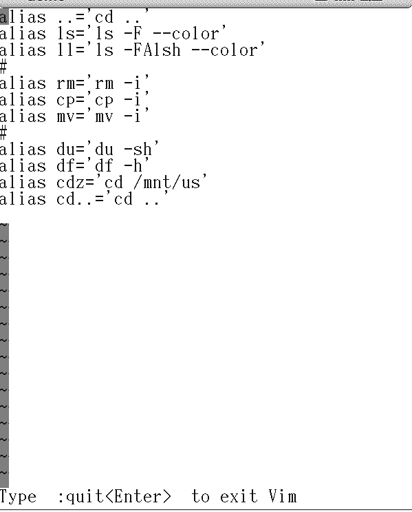

Vim? Isn't that for cleaning things?
This is great, appreciate the linky
And a Word To The (un)Wise:
ERR? I'm using Myts, How do I exit vim (on a 3)?
Here are those pesky codes to get yourself out
Aa+c
Back+.
q
Back+q
Enter
is: escape colon kuew bang
like ^c:q!
(you just haven't lived unless you've been stuck inside an editor with the rootfs rw and root permissions - with absolutely no idea of the keycodes to exit)
Ah happy days, thanks for the hookup, I've put it on the awesome pile.
Oh, and it "just works" no fiddling. on 3.4
