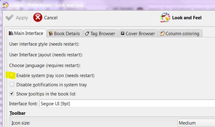

Crashing calibre that much--especially with the other crashes you mentioned when switching libraries--sounds like it's some problem outside FFDL.
It's possible that FFDL is doing something subtly wrong that Mac doesn't like, but I don't have a Mac to test with. Nor have I had an reports of problems from other Mac users.
The only thing I can suggest is that I recall hearing from someone once that turning on calibre's 'Enable system tray icon' feature made calibre flaky on Mac or Linux.
JimmXinu is offline

Re: Reports: I’ve been using FFDL with Calibre for a few months. There’s a threshold of usability below which it didn’t seem worth it to ask. Until I worked out enough of a pattern of things to avoid in order find that it was possible to have a functional library it didn’t seem stable enough that it would be useful to pursue. If I’d given up in frustration before I’d gotten there, I wouldn’t have reported.
I read the same thing, so I never turned “Enable System tray icon” on in the first place.
Is there a different thread or forum I should try asking about the crashing in?
