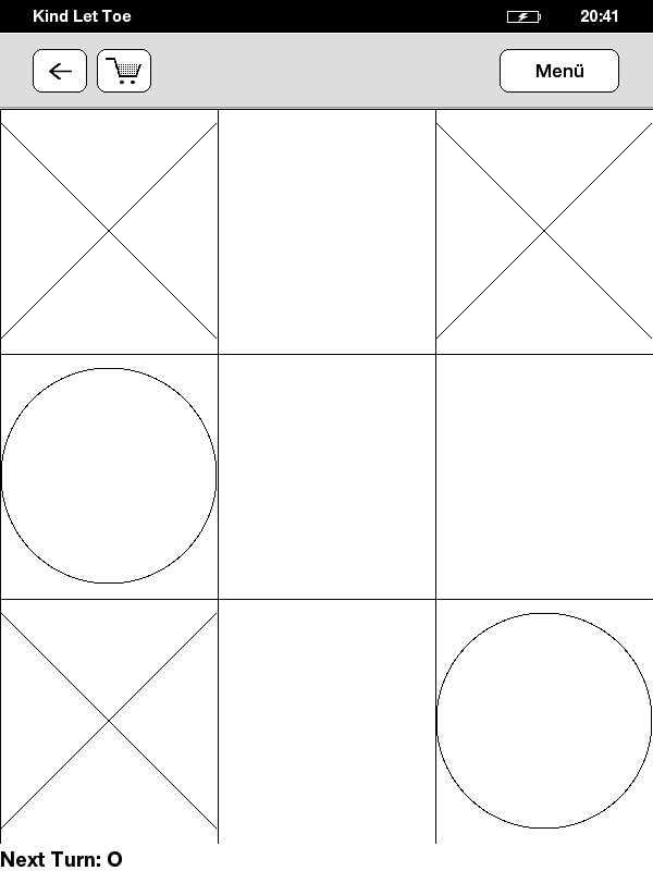

So, this is my first Kindlet.
It allows you to play the popular TicTacToe game against yourself or an human opponent.
I created this mostly for educational purposes and only tested it on the Kindle Touch and would wonder if it would work on any other Kindle without further improvements
(For unknown reasons i used JPanels+MouseListeners instead of JButtons+ActionListeners. I think the Actionlisteners would be more likely to work on the KNT)
I'm planning to go into detail about the development process, but at the moment i only have limited time and my internet will possible be gone for a few weeks in the future, so i will post this now, before i have forgotten everything i have done.
First of all i used the JDK from this site (untrusted source?!) and configured my eclipse to use this JDK (Window->Preferences->Java->Installed JREs->Add... and later in the create-project-dialog select the right JRE)
The source .zip file also contains an Applet-class, that can be used to view the Kindlet on your Home-Computer. This was great for testing.
When i was done coding, i exported the Project as a Jar-file (not runnable) out of Eclipse and manually edited the META-INF/MANIFEST.MF file to contain
