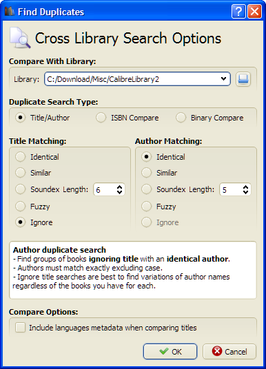

Beta for next version
A number of people over the last year or so have asked for the ability to do cross-library duplicate comparisons. I've finally reached the breaking point of deciding a personal need for using it myself and have put something together.
So on the menu you now have a "Find library duplicates..." option with a screen that looks similar to the regular Find book duplicates one. However you can see you choose a library to compare against up the top, and have way less options at the bottom since UI stuff isn't relevant.
As I have stated previously the only practical approach to working with the results is to simply produce a report. You can copy it to your clipboard / text editor, switch to your other library and manually decide what to do about them. It would be an *enormous* amount of work to wrap a cross-library gui for merging/deleting so it isn't going to happen - we discounted having a special plugin screen when originally designing this plugin and the reasons more than equally apply here.
A couple more things to note:
  • The report only shows the results of comparing books in the current library with books in the target library. It intentionally will not show you duplicates that exist only in the current library, nor duplicates that exist only in the target library. It is for a direct cross-library comparison only.
  • If you do an "Ignore Title" search (i.e. matching only authors) then the report output will differ and show you by author name which authors match and the books associated with that author in the target library
  • If you do a binary search, it shows you which format is the binary duplicate
  • For title/author/isbn searches, it will show you what formats if any exist for that book
  • Unlike "Find book duplicates", it is possible with "Find library duplicates" to do an Ignore Title, Identical Author search. This is a combination which makes no sense when only looking in your own library, but makes perfect sense when comparing across libraries.
I haven't even had a chance to run this on my libraries at home as yet so it may have gremlins. I have run it against some small test libraries and it all seems to do the right thing but any feedback is appreciated.

Old 07-20-2012, 04:35 PM   #280
kiwidude
Calibre Plugins Developer
Posts: 4,775
Karma: 2209206
Location: Australia
Device: Kindle Oasis
v1.5.0 Released
Changes in this release:
  • Add a "Find library duplicates" option for cross-library duplicate comparisons into a log report
  • If currently running a duplicate book search and execute a metadata variation search, clear search first
See my comments above for a description of how the cross library duplicates search work. Note I did find a bug in the beta for "Author only" searches which is corrected in the 1.5.0 release (so don't be surprised to see more results now than you saw in the beta!).
kiwidude is offline   Reply With Quote
Old 07-20-2012, 08:55 PM   #281
Posts: 22,480
Karma: 31000706
Win7 Pro SP1|Calibre 0.8.61 - for Library Compare. This will save me a lot of time.
Minor Inconsistency
The Compare With Library drop down does not show the list of Calibre Libraries, as I anticipated it would.
Instead I had to navigate to the corresponding folder via the Browse button, using the standard Windows Open Folder dialogue, which opened up assuming my Calibre Libraries were in my Windows Documents Library. I can imagine this might confuse some people. Calibre has a list of Libraries & Folder Paths behind the Library Quick Switch flyout menu. IMO that list should be used here.
Suggested Enhancement
Save results to a text file - I appreciate I can copy it to the clipboard, open a text editor, paste the clipboard and save the file (or shock horror - print it) - but ...
Old 07-21-2012, 03:59 AM   #282
kiwidude
Posts: 4,775
Karma: 2209206
Location: Australia
There is a reason behind the library path thing. The way calibre chooses to display library names has some limitations which from time to time the odd user has come on to complain about. For users who only have a small number of libraries I completely agree that a dropdown of names would be consistent and simple. Three issues though. First calibre has a limit to the number of libraries it remembers, and there has been at least one user I have seen come on these forums and complain about that. Secondly I need to cater for the user comparing against a library they may not yet have opened in calibre on this machine. And thirdly what about a user who makes a copy of their library folder onto a different drive for backup and is using this feature to compare. Just displaying the calibre library folder is not enough to differentiate which one they are pointing to.
So I took the easy way out and took the same approach as the switch/create library dialog - that is the part of calibre I have chosen to be "consistent" with.
Your second suggestion of a save button is an excellent one, I will add that in.
