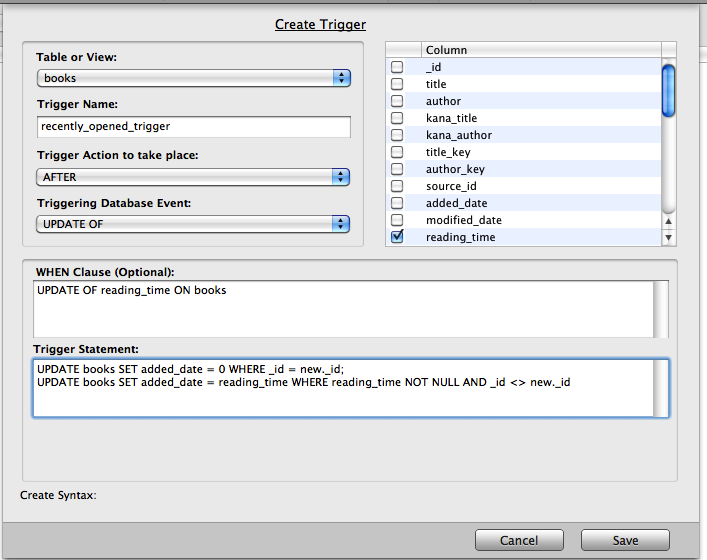

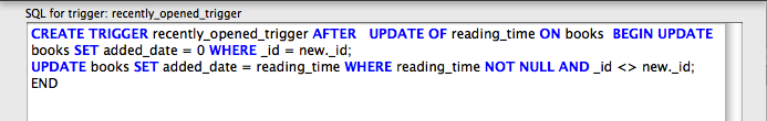

@Snarkophilus: I think you're right that the database is being updated a lot. I'm getting the spinning arrows more than usual, plus for some reason the alphabetization when sorting by filename has gone wonky (it seems to be using "date added" rather than "alphabetical" for some, but not all, books).
I experimented some more -- this is like a puzzle where you know you have all the pieces but you're not sure where to put them. But I think I finally figured out which snippets of code go in which MesaSQLite box. Screenshots attached. So far everything seems to be working properly. Yippee!
Thanks Simon and jackie_w for your help -- and of course, thank you Kolenka for the nice piece of code!

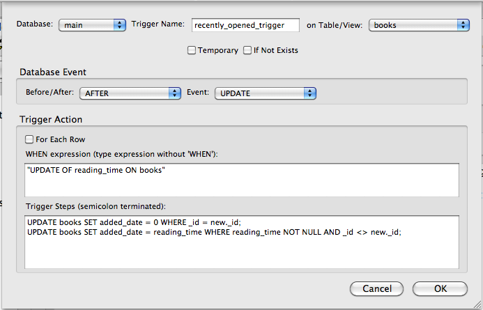

I feel like a complete idiot. After successfully figuring out how to create the trigger using MesaSQLite, I decided to try it using SQLite Manager (which I wasn't aware of before, and after taking a look, I rather like it). Should be simple, right? Well, I've tried for over an hour, and every time I try, I get an error -- most commonly "near UPDATE: syntax error"
J.L.C., would it be possible for you to upload a screenshot of what you did?
The closest I get without an error is attached. When I remove the quote marks from the WHEN clause, I get an error message. But the resulting trigger with quote marks isn't exactly the same as Kolenka's original code, and I don't know enough about this stuff to know if it makes a difference. Help!

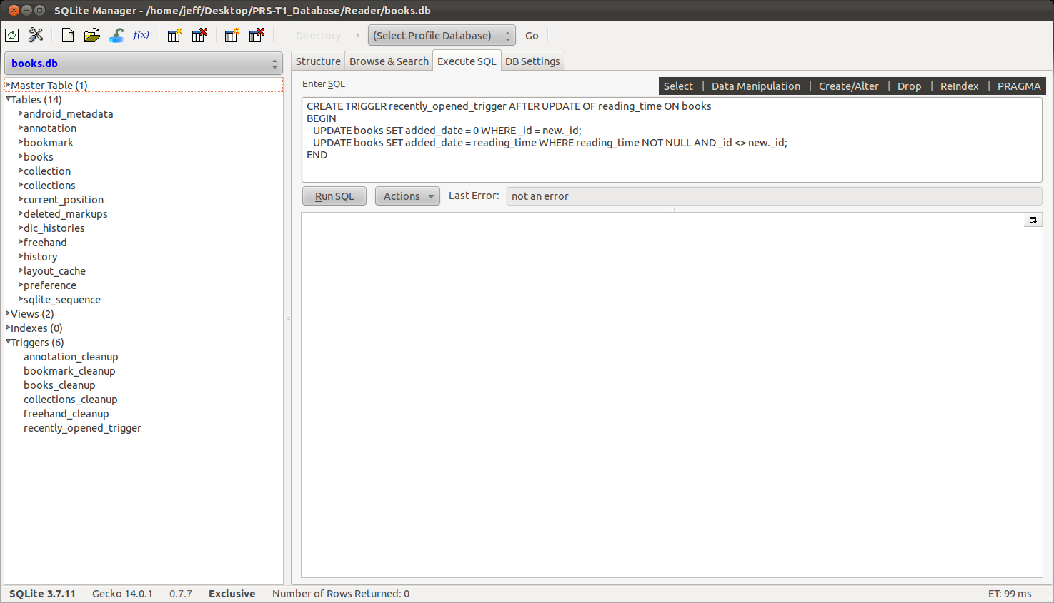

in the absence of JLC, re: the SQLite Manager Firefox add-on, you could try doing it this way:
  1. Open books.db, click on the tab 'Execute SQL',
  2. Copy/paste Kolenka's code into the 'Enter SQL' panel underneath
  3. press the 'Run SQL' button. You should see the new trigger name appear in the left-hand panel after the existing 5 cleanup triggers
The attached image is before the trigger is created, not after.
Sorry for the late post, it looks liek jackie_w came to the rescue though!
Attached is my screenshot.
I am on Ubuntu 11.10 64-bit.
I opened the books.db using the 'All files' option from the open file dialogue. Then just copied the code as written from the OP into the 'Enter SQL' field on the 'Execute SQL' tab. Then I just copied the books.db files back over to the reader and over-wrote the existing ones.
Name:	SQLite Manager.png
