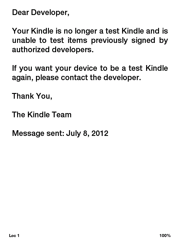

Device: Kindle 3
Ah, stupid me.
I forgot to mention an important thing, it's not just that the file is removed, there also appears a note from Amazon with something about my test kindle installation.
When I'll have time and mood for seriously digging into it (and maybe GM's video) I'll surely post my progress.
This also happened to me only once when I deregistered and registered again. It seems that amazon clears the keystores on every deregistration.
