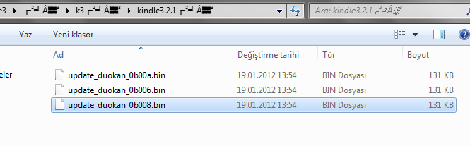

  1. backup your all files in your Kindle
  2. Reset to factory default (menu>setings>menu>reset to factory defaults)
  3. ( uninstall the jailbreak ?? )
  4. copy DK_System folder and appropriate update file
  5. menu>settings>menu>update
after the installation of DuoKan you can jailbreak again.
You should use the update files with size:131kb (not 2kb)
Name:	DuoKan install.png

Originally Posted by theusualuser View Post
or do some of the bin files need to be put on there without being inside the folder that they're in when I extract them?
That is exactly the case for the update files.
unfortunately I don't have a K3 nearby, hence uploading a screenshot could not possible for me.
you should copy
  • DK_System folder as a whole
  • and 3 update files: update_duokan_0b00a.bin, update_duokan_0b006.bin and update_duokan_0b008.bin
to the root folder of the kindle
thomass is offline   Reply With Quote

Thank you SO much. I did it just like you explained and it didn't work the first time. I then decided to try an older version of Duokan 2012 and that time it actually worked. I updated it via wifi (the download kept failing, but after about the 15th time it worked) and now it's all set. Looks wonderful. Again, thanks thomass, you're my hero!

Well, i think the problem was that I had found the latest version of duokan (something like 7-13) somewhere and was trying with that. It turns out that you need to use the version currently on en.duokan.com, which I think is from January (1-14) http://en.duokan.com/?page_id=41 . So after I used that one, then everything worked like it was supposed to and I was able to update over wireless to the latest 7-13 version that's floating around.
Again, thanks for confirming that all three .bin files needed to be placed directly in the root directory of the Kindle. Combine that with making sure that people use the 1-14 version on Kindle 3.3 firmware, and I think we've got a working solution to install Duokan 2012.
