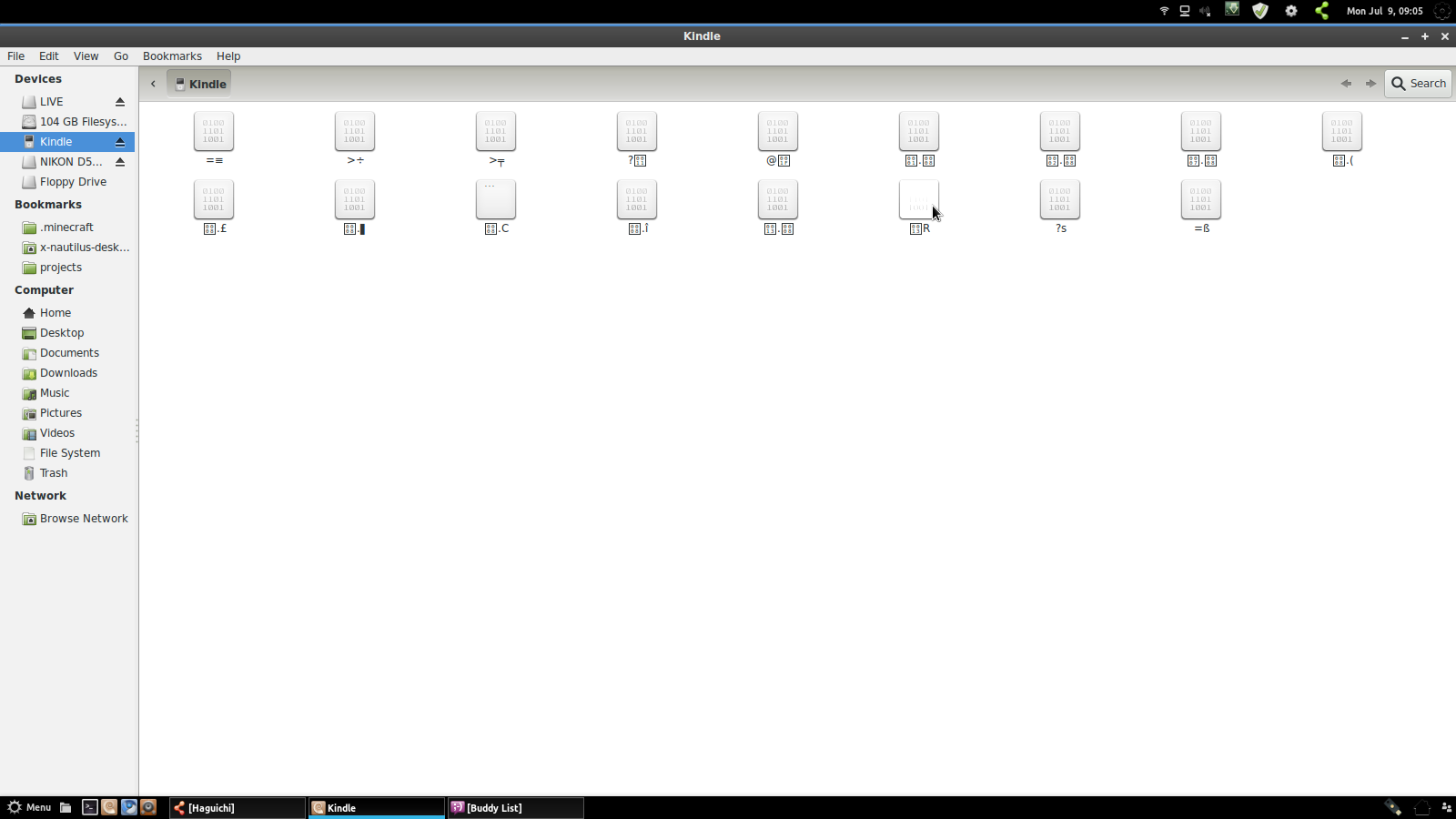

Successful Debrick -- with a hitch... EDIT: FIXED
Originally Posted by arooni View Post
Has anyone with a bricked Kindle 3 been able to do a recovery using this method? I'd love to know if this is something I should pursue or if I should just wait to get a broken screen Kindle and just swap mobo/parts.
EDIT:Just thought i'd update this since GeekMaster threw in a reference to me in the debricking sticky thread.
Successful Debrick using ATK
I had a bricked Kindle I had given up on (would only boot into diags), and using Freescale's ATK program (windowsXP 32 bit, physical Hardware) I unbricked it by flashing the rootfs with an image i got from this forum somewhere that i renamed <imagename>.img.bin( i cant exactly remember where i got it...). To test ATK, i flashed Seaniko7's custom kernel (even though i already had it... lol) and then proceeded to flash the image. I left it running overnight, so sadly i can't give you a time estimate... In the morning, i booted it up, and it booted normally! the only problem i had was then that the FAT32 table was corrupted, so I did a factory reset which temporaily fixed part of it but unzipping an update file gave me errors so i got a friend to run mkfs.vfat (as i'm still a linux noob ) for me on my Raspberry Pi. now i have a completely functioning Kindle!
(the image below is the corrupted fat32 partition (/mnt/us) on the kindle when i plugged the kindle in to install usbnetwork on LinuxMint)

Originally Posted by qlob View Post
I just finished flashing my k3g that i had pretty much given up on. It works great now, except for the fact that when i plug the device into my linux box, i end up with 17 items, totalling 9.8 GB, according to nautilus. They are read only, which leads me to believe a small part of /bin or something got flashed in the wrong place or something...
The image shows a trashed FAT-32 file allocation table.
I think the K3 works the same as the other, if you ssh into the Kindle and destroy the file system on mmcblk0p4 with zeros, when the Kindle is next re-booted it will reformat the partition for you.
It would be best if you researched these threads a bit before trying that at home. I am not sure the K3 will auto-reformat the user storage partition.
Ok will try that.
