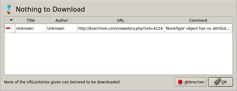

Originally Posted by Zauberlehrling! View Post
Great, it works perfectly.
And here comes something new. Again a story what can't be read.
I don't know if that is caused by the same thing.
http://www.ksarchive.com/viewstory.php?sid=4124
See again attachment.
Name:	Screenshot from 2012-07-09 19:13:54.png
Zauberlehrling! is offline
