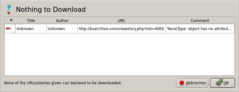

I can't say thank you enough for everyone who works on that plugin and makes it work.
I came across an interesting thing. There is one story on ksarchive.com what can't be downloaded. Maybe someone wants to try and will see the error as I do.
Link is: http://www.ksarchive.com/viewstory.p...4065&warning=1
The message I get can be seen in attached picture.
I'm using the latest plugin, but have the same problem with this. I can read the story on the website, but can't download it. Something to do with the rating perhaps?
I have an account, but even after I put my name and password into personal.ini, I got the same error.
For no apparent reason, the author included an extra--and empty--category link in the story description.
<a href="browse.php?type=categories&amp;catid=1"></a>
Attached is a fixed version you can use, and it will be in the next version, but I'm not going to do a new version today for just one story.
Attached version updated for tweak to 'get urls from page' feature.
Attached version with another ksa fix for poor summary html.
Attached version with fix for wraithbait story with blockquote tags.
Attached version with fix for August dates on dramione.org.
