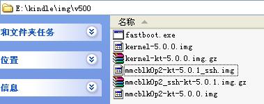

I think the kernel-kt-5.0.0.img.gz is the diags kernel, so I try the commond
"fastboot.exe flash diags_kernel kernel-5.0.0.img" ,it yet not work.
I'm sure flash the right diags kernel and diags paritions follow the guide.
I get the 5.0.0 version file (kernel-kt-5.0.0.img.gz and mmcblk0p2-kt-5.0.0.img) from "http://gitbrew.org/~dasmoover/kindle/touch/forensic/"
I try many times , still in big tree , not display the diags menu. I doubt it's not work , so I reboot with main mode, then my pc identify the kindle usb disk , with about 5 second , the usb disk is breaked automatically. So I think the 5.0.0 diags kernel is work , but not in the diags paritions or display output is something wrong.
So, I try the 5.1.0 version file, get the same result.
kernel 5.1.0 http://www.mediafire.com/?sc3mvazvlxsage1
mmcblk0p2_ssh-kt-5.1.0.img.gz http://dl.dropbox.com/u/29927061/mmc....0.img.tar.bz2
I doubt new kindle touch with firmware 5.1.1 do some change in hardware or my hardware somewhere is error.

Image #2 lists a "main_kernel" and "mmcblk0p2" images.
Those do not match, the "main" image is an "mmcblk0p1" file name.
Thank you for your answer , I want to known if main_kernel and diags_kernel is diffent , and how to identify kernel-kt-5.0.0.img.gz I get is diags kernel?
