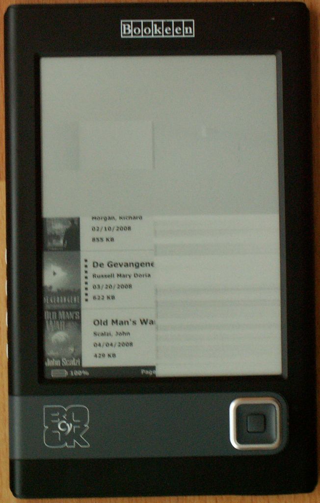

My screen also suddenly went dead. I was reading one evening. The Cybook was in its case. I switched it off and placed it on the table. The next evening I opened the case and switched it on. I had a few normal screens during the boot process an suddenly only the the lower left part was working. It was exactly 1/4 of the screen. This must be a flaw in the design or a bad batch of screens. It is almost impossible to break anything in exactly 4 equal parts by accident.

That sounds like a display controller fault, Ortep. When that goes you generally will "blank out" exactly a half, or a quarter of the screen. Should be a warranty fix.

Bookeen asked me to send a picture of the screen to them. I just did

Would you like to post the picture here too?

Here it is

Yes, that's the controller for sure. Definitely NOT a physically broken screen!
Hmmm...I just got an email back from Bookeen. They told me it was a broken screen and they need to replace it. There was no mentioning of costs however

Well, it is a component of the screen, but the controller, not the "physical" glass screen. I'm pretty sure that it will be a warranty repair. Please let us know the outcome!
