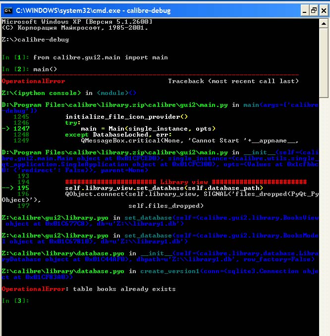

Thanks for the reply. Output in debug mode s. Attachment

Delete the file library1.db

It's work!
But this library file was on network disk (Z, mapping for user home folder in our domain) by setup created. Imho this is a bug!
