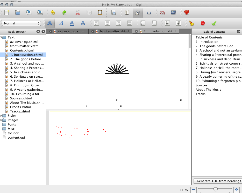

i have a validated epub made from indesign. When i open in SIGIL, i see no text. I see the images, and I see quote marks and double-dashes. In the code view I see little red lines.
I have attached a screen shot of the split view pane. My chapter icon and quote marks are in upper pane, the red lines are in bottom pane.

This issue has been reported. Unfortunately, I cannot reproduce it and I develop on OS X. If I cannot reproduce the issue I cannot fix it. My guess is it's some issues with your system and Qt. Possibly related to fonts.

It almost seems that the color of your text is white. If you select some text, is it visible then?

I was thinking that...Except, the book is in split view and
color: white
style should not affect CV.
But some sort of QT color (card) assignment shift might affect all.
Punctuation usually follows Paragraph colors unless it is part of tag: ex. class="foo"
OP are you running the 'stock', standard system color theme?

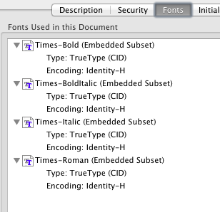

I was finally able to get back to this project. I went through and made sure every instance of embeddable fonts were removed, so that only Times and its versions are there. I made a pdf of the epub and checked fonts, and only Times shows. I am attaching the screenshot..
I think it must be some font that i have in my system that's not in any way associated with the epub. But I have no idea. Even after stripping out all references/calls to anything but Times, I still do not see WYSIWYG type in SIGIL.
Could it be because I am calling Times, and not Times New Roman? I'm going to try that. I looked at the fonts in the choices above and it's Times New Roman, not Times.

Have you tried simply embedding an ENTIRE font package--not an embedded subset? What I see when I look at those is that they are encoded. I suspect that they are encrypted (I don't use obscured fonts--it's an Adobe specialty, so my Foo in this area is not mighty), but why don't you try yanking that out and not calling ANY FONT, and see what happens, first?

I think if she just yanks out the font, and doesn't call it, I'd be surprised if that doesn't fix it. I'm relatively certain those are encrypted, which means, in a Type-1 font, that she can't draw the character outlines, IIRC. .
Susan: Does your ePUB have an "encryption.xml" file in your META folder?
ETA: See this: http://indesignsecrets.com/cid-ident...s-are-back.php ; CID refers to a character map, OR encoding. Really--try deleting that font in its entirety, and I suspect you'll be able to see your ePUB.
