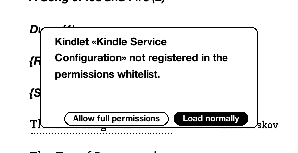

Hello,
I've written a small tool that allows loading Kindlets outside of their sandbox. Right now it only works for the Kindle 4 (software version 4.1.0), but I think it could be easily ported to Kindle 3 and Touch.
It implements a custom classloader for the kindlets, which skips all the sandboxing checks: certificates, java permissions and class whitelisting. With it, when launching a Kindlet for the first time, you will get a dialog (see attached screen-shot) asking if you want to allow it full permissions (using the custom classloader) or load it normally (inside the regular Kindlet API sandbox).
If you load it with full permissions:
  • the certificate checks will not be performed; so the kindlet can be signed with a developer key, or not signed at all, it does not matter; you will not need to install any developer certificates.
  • the kindlet will have full access to the device's filesystem, not just inside the regular sandbox -- it will be able to read and write any file.
  • the kindlet will have full access to the Java framework's classes, not just to the Kindlet API. This is not as useful as it may sound due how heavily obfuscated the framework is.
Detailed documentation is available, as well as an already-built .jar ready-to-use.
Hope you find it useful .
Cheers,
-pwr

How is this different from ixtab's class loader replacement?
Originally Posted by ixtab View Post
...It allows to escape the restrictive class loader, and also allows you to do other nifty things, like gaining additional permissions to write to the file system, read additional properties etc.
Alternative implementations are welcome. We can learn things from parallel development efforts. Sometimes combining the best ideas from them can result in a much better hybrid implementation. Thanks for sharing this.

It only allows for more powerful Kindlets. While using the available Java framework classes is possible, is quite limited compared to ixtab's; certainly it does not offer the possibility to change the Java bytecode on-the-fly. On the plus side, it does not require having to mess about with the bytecode . It's more high-level, if you like, with all the benefits and disadvantages it implies.

Great! More power (than stock firmware) with less "tampering" may not break so quickly with the next firmware update, requiring less "end-user maintenance".
Your method may be more desirable for beginners, while power users may prefer ixtab's method (which I use myself).
