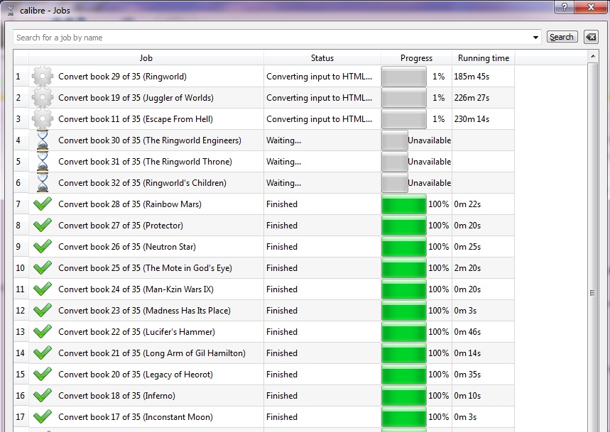

Oops, I may have aborted the process too early?
It was, I thought "hung", so I pulled the plug at 230 minutes.
And Sorry, it wasn't text to epub
It was mobi to epub.
Of the 35 books being converted it was stuck(?) on three mobi books and 3 waiting, see attachment.
Do I start the conversion again and let it run for more than 6 hours????

Let it run till it is done or crashes
You can't tell which will need this from the outside
I have had a few take 24 hours
I had one that ran for like 12 hours on my laptop (AMD Turion dual core CPU...not the speediest CPU in raw crunching ability) before I gave up.
I gave up and moved it over to my desktop (Phenom II x4) where it had a lot more CPU/memory bandwidth and it finished in a few hours instead.
It was html-> epub with a LOT of CSS to process. I haven't had one take longer than 3-4 hours but I've heard it's possible if the CSS is complicated.

Hi,
Resizing and converting images can be quite time consuming and memory intensive.
Also often long execution times in python are related to memory allocation/deallocation thrashing. All strings in Python are immutable. So any time you append or delete or modify a string in any way, python allocates new memory and deallocates the old. So appending/changing lots of little substrings in a long (large) string can result in massive thrashing of memory (the cpu is pegged just deallocating and reallocating memory and the paging and virtual memory that can be associated with that).
Walking and modifying long css and xhtml files can be quite costly is lots of little changes are needed on the large xhtml file.
The only "workaround" for the python approach of having strings be immutable is to create lists of string pieces and when finally ready allocating the required space once, and then copying all of the strings in the list (in order) into that newly allocated string.
This approach prevents the memory thrashing and can significantly speed up operations in python on memory limited platforms.
Perhaps these may be contributing to what you are seeing. Does your "benchmark" conversion properly resize and convert images and properly process/convert CSS entities, processing large xhtml files, etc?
What size file was that?
I've been running the conversion process process on a 50Mb PDF to ePub file.
It's got images in it but they're mainly B&W. It's currently just gone over 4 hrs.
underdunne is offline   Reply With Quote

ANY SIZE (or Size Doesn't Matter' )
That is why my line above: 'You can't tell from the outside'
Proceed to rule 1 (and be prepared for 24 hours or more with your other activities. Cancelling only means you start over )

Bummer...637 mins and still only 1%. wish there was some better indication.
