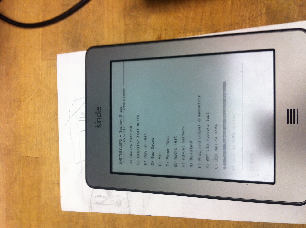

I copied over the files, rebooted, came to the screen, scrolled to where it said Exit, Reboot or Disable Diags. When I tapped that it froze and has remained frozen. It is on external power. Holding the power for 20 seconds does nothing.
ricocarlos is offline   Reply With Quote

Screenshot
Here is an image of where it is frozen.
Dead battery? Try plugging it into a power cube for a few hours, then use MfgTool to get it into fastboot mode and charge it a few more hours...
I had it charging overnight so I don't think the battery is dead.
How did you charge it?
There are reports that the kindles do not charge in diags mode.
I have also had kindles go totally dead (to the point where I thought they were bricked) when left in diags with the USB connected.
That is why I said to use an standalone charger (external power cube).
I've tried charging with the power cube. It shows the amber light as though it is charging, but after six hours of charging it is still dead.
Does the display still show diags mode as shown in the photo that you posted?
If it is in diags mode, it may take a LOT more than 6 hours to charge, even on a wall charger.
After charging, can you get it into USB Downloader mode? What is the USB VID/PID after you try to get it into USB Downloader mode?
Does MfgTool see it? If yes, then can you get it into fastboot mode? Does the fastboot tool see it? What is the VID/PID after you try to get it into fastboot mode?
When you report it as "still dead" without any useful details, that does not supply us with enough useful information for us to help you diagnose the problem.
We need to know what steps you have taken to try to debrick your kindle AFTER your charged it, and what were the results of each thing that you tried. How did you decide that it was "still dead"?
Please supply the answers to all of the above questions, so that we can help you.
First of all, I need to thank you for all your help. I really do appreciate it.
The display still shows the same as my photo. After charging overnight, I plugged it into my computer and it detected the Kindle, but nothing shows up in My Computer.
Where can I download MfgTool and instructions?
I am sorry to respond so sporadically. I have been sick today. Again, thanks so much for your help.
When the kindle shows up as a 0-byte empty usb drive, that means that it is either in low-power mode (from a low battery), or it is bricked. Sometimes the REAL usb drive shows up complete with all its contents for about 10 to 30 seconds during bootup, before switching to low-power (Fake USB Drive) mode.
Many of the questions that I asked are still unanswered. If you want help, you need to do as we request so that we can help you to HELP YOURSELF. We do not have physical access to your kindle. We must rely on you to do the steps that we cannot do for you.
Please answer my questions. If you do not answer our questions so that we can help you, then why do you waste our time by asking for help? I will not ask again.
