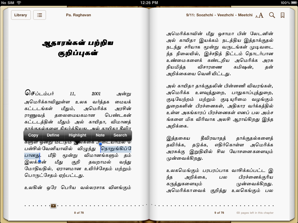

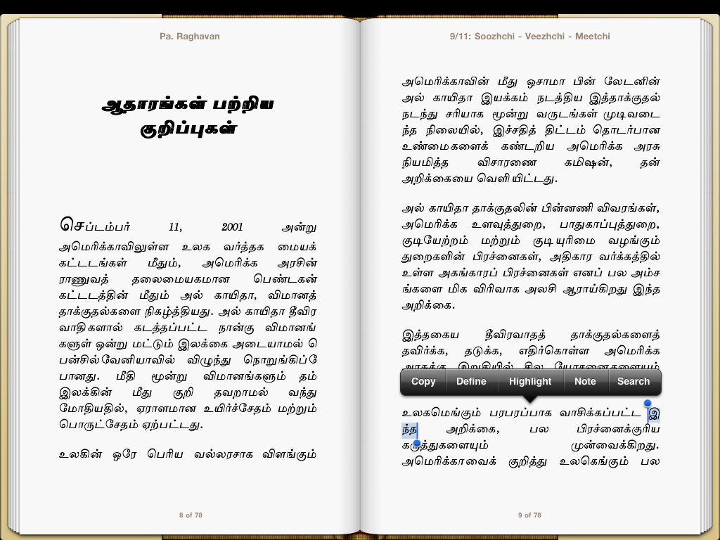

My problem is:
I have created one ePUB (TAMIL font "SHREE-TAM-0800.TTF" embedded) and loaded in Ipad ibooks. It displays well but some word unwantedly broken and gives bad reading experience at the end of each line. (Refer attached screenshots)
So kindly help me how can i solve this issue.
Thanks in advance for suggestions and help.
ID:	86187   Click image for larger version

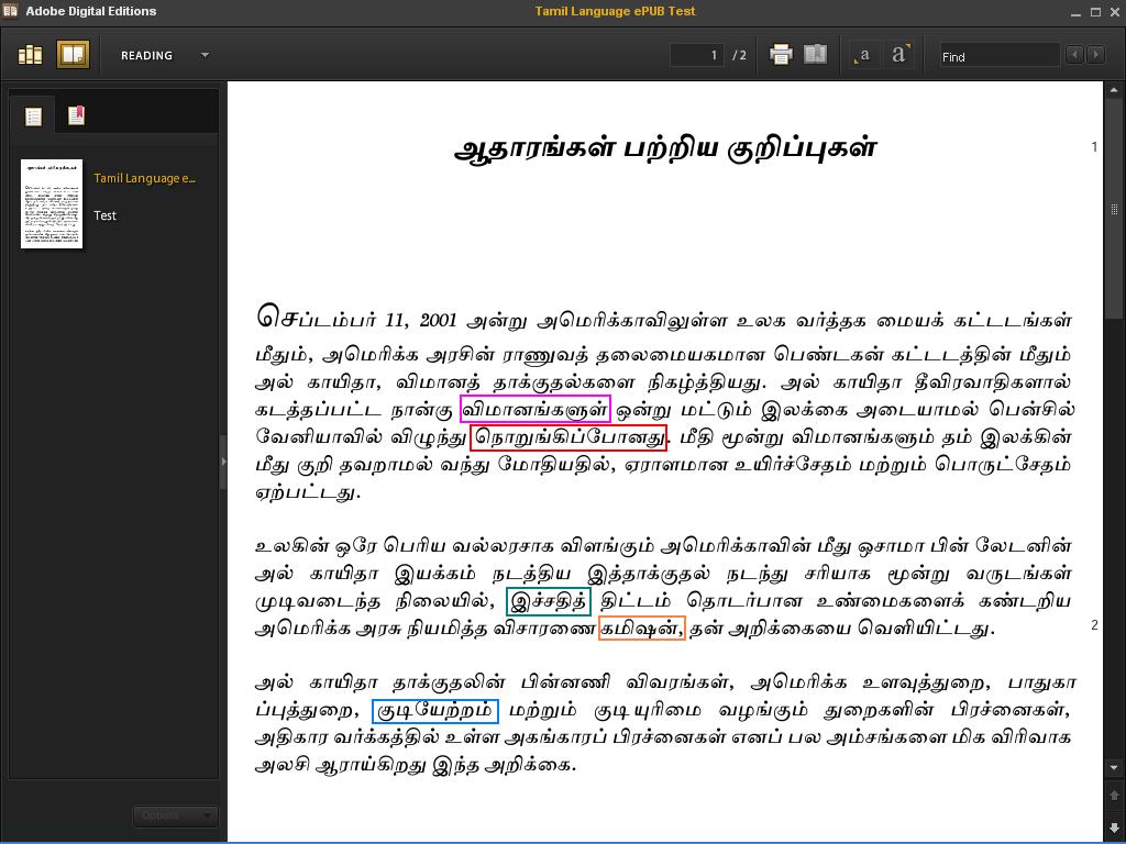

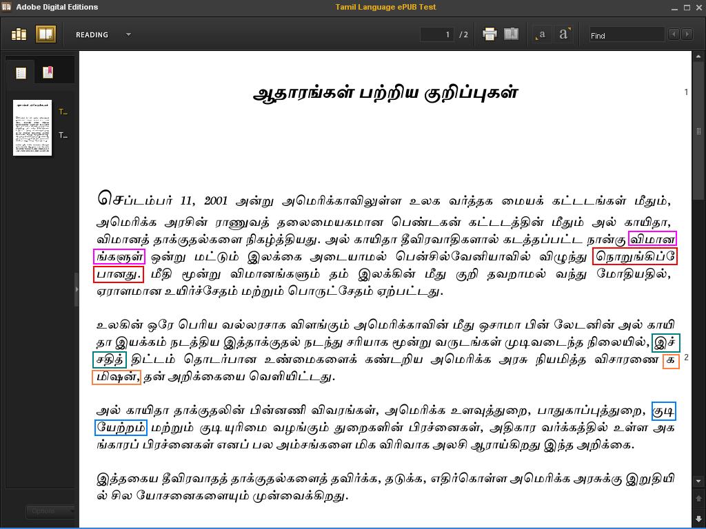

I have updated Unicode encoding & language declaration in .xhtml file but no favorable result for unwanted word break. (Attached updated sample for your reference)
I have also attached screenshots for correct & unwanted words breaks example.
It would be more helpful to me if you could provide procedures for source files to Unicode conversion or any website link.
Once again thank you so much for your reply.
I had a quick look at your ePub and noticed that the source .html file is not Unicode encoded and moreover lacks a language declaration.
However, the ePub standard requires all source files to be encoded as UTF-8 or UTF-16 files.
You'll have to convert your source files to Unicode and embed a Unicode compatible Tamil font.
Name:	Correct word break in ADE for Tamil font embedded ePUB.jpg
ID:	86233   Click image for larger version
Name:	Unwanted word break in ADE for Tamil font embedded ePUB.jpg

Simply adding "encoding="utf-8"" to the .html file does not work. You'll need to actually convert the .html file to Unicode.
There seem to be several different Tamil code pages in use; you'll have to find out the encoding of your .html file and then use a converter to convert it to Unicode.
Simply google for Tamil Uncode converter and Tamil Unicode fonts and pick one that works.
Alternatively, save your source file as Unicode with your word processor/editor.
You could also try to copy the text to the clipboard, paste it into BabelPad and then save it as a Unicode text file.
BTW, even if you manage to convert your source file to Unicode there's no guarantee that this will solve your problem.
I wouldn't bet on ADE, because the current version is pretty limited when it comes to non-Latin alphabets. However, there's a good chance that a properly encoded Tamil ePub with Unicode .html source files might work at least on the iPad.

Hi Doitsu, you are right.
As you said, I have found some solution.
By changing the actual content (i.e .html/.xhtml) into UNICODE text using UNICODE converter we can solve this unwanted word break issues.
Note: Fonts not required for the UNICODE formatted ePub and looks good in all devices.
