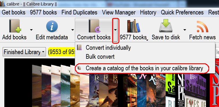

Between the sample CSV file provided on this page of the Goodreads site and the create a catalog feature (see attached) that will export the data you select as a CSV file you should be good to go.
Additionally once you do the major import you can keep your calibre library and Goodreads in sync using the Goodreads Sync plugin.

@Jnassise I may not have been clear in my previous post. You do not have to remove any identifiers because the create catalog feature will allow the exporting of just the ISBNs (see attached) to the CSV formatted catalog. You do not need to include all of the identifiers if you only choose isbn that is all that you will get. No amazon numbers will be in the created csv file.
