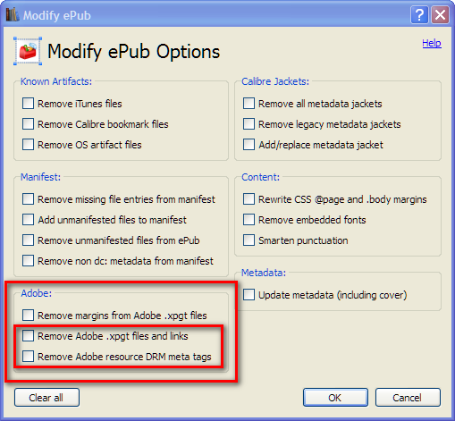

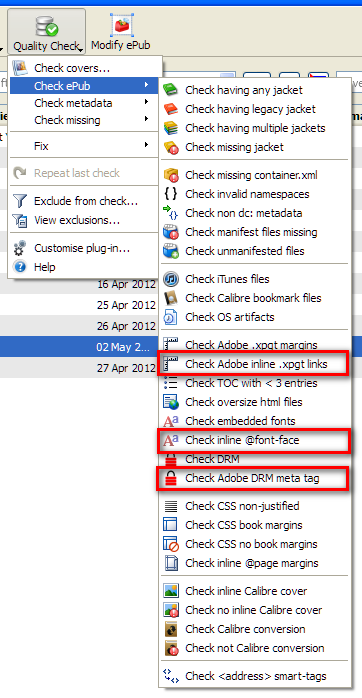

@agama and @paulfiera...
I've got a new version of Quality Check (ready to test) and Modify ePub (in progress) as per the screenshots below... yell if you spot anything obvious I have forgotten.
I am intentionally not removing @font-face stuff at this point but if they are replaceable with a regex (rather than requiring css/html parsing) I will add support for it. Perhaps one of the css gurus out there may care to comment on whether some simple regex like "@font\-face\s+{[^}]+?}" would cover sufficient use-cases or not...
The other thing I want to investigate is cover insertion at some point though I have no doubt there are gremlins in there. I have seen people mention ePubFixer as something they use currently - is its approach recommended? I could steal ideas from that, but the brief read of its website said it produces svg covers, and I vaguely recall Kovid saying something about those and calibre having options not to produce them which presumably are for a reason...
Any chance Kovid or someone who knows about these things could enlighten me with some hints? Idolse "kind of" volunteered to add support for this feature a very long time ago but he seems to have been distracted by other things.

kiwidude: thanks, thanks and thanks
Just being able to identify which epubs have inline font declarations it's a huge time saver. I can take it from there and edit these epubs in Sigil and remove the inline font declarations.
Right now I'm opening every single epub in Sigil and checking for inline font declarations. When you take into account that this is a 4.000+ epubs library, well...I'd probably have to quit my day time job to be able to finish this quest in my lifetime
Regarding covers: I'd just want to put my 2 cents. More info here.
Many, many thanks, again.
